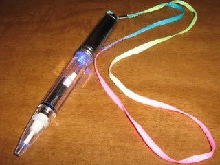

lol about the chip, its kinda funny...
it came out of a light-up pen i got from a party store :P
i think theres still a packaged one around here somewhere, ill try and get a picture of it so you can see

« Reply #17 on: December 05, 2007, 02:05:17 PM »
heres the pen i got... it has this rainbow lanyard on it, all the ones ive ever had, had it, so you might wanna look for that
heres the part that houses the chip
here, you can see that its protected.. its basically just a black blob
and heres the chip... just take off the leds, button and battery spring and solder wires in their place, you also need to solder a wire to the space that used to make contact with the housing
Heres all the solder points... the 5VDC + and Led common + are the same, but since theres already two different joints, i used it this way
