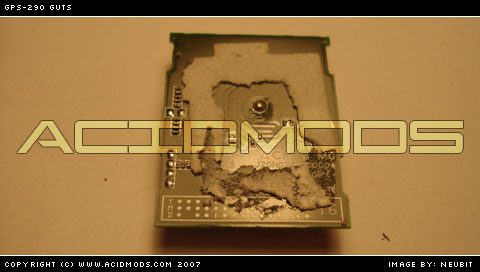

8- The GPS in also glued on the bottom, this time you cannot stick anything underneath because chancer are, you will destroy some of the micro resistors they use. Using your hands keep trying to take out the board, don't be worry, use as much force as needed. A last the receiver will pop out.

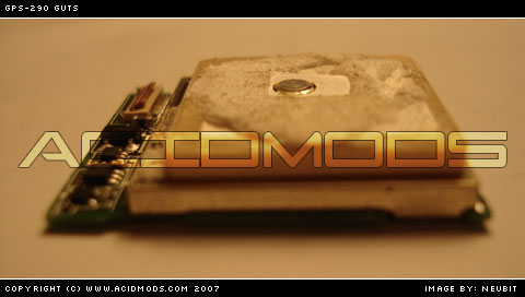

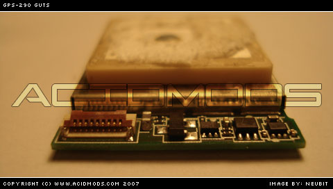

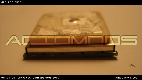

Here are some snaps of the receiver for you to drool over
Bottom:
Top:
Side:
Back:
