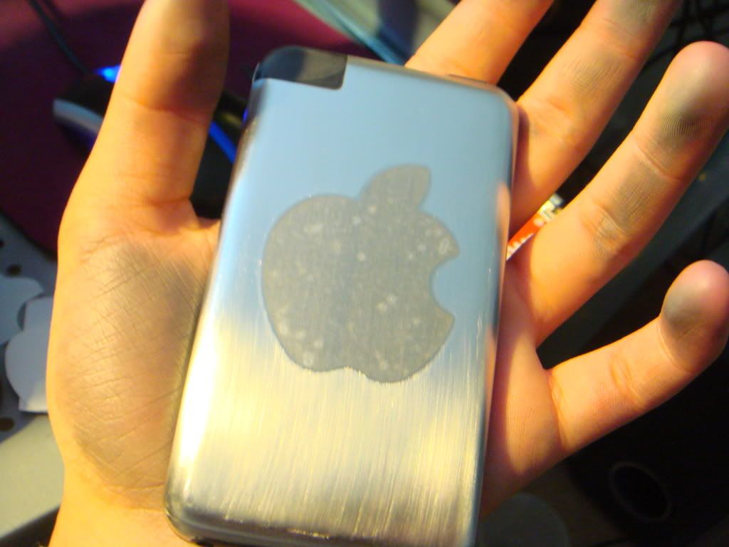

Aahhhhhh... That fresh metal smell :)
« on: January 19, 2008, 08:22:40 AM »
 :dribble: :dribble: :dribble: :dribble:
After I was done I touched my eyes and licked my hand  to see how it was:boxed:
Just kidding about the licking touch my eye part.. lol
 :taunt:

« Reply #4 on: January 21, 2008, 08:52:13 AM »
If only i could get the lines to be vertically straight...
lol
and laser etch the apple logo

Nice, but i dont like the apple logo, way to big, and not the right shape.
Offline Sil3ntP3nguin
  • Posts: 485
  • Projects here and there!
Re: Aahhhhhh... That fresh metal smell :)
« Reply #8 on: January 21, 2008, 06:40:33 PM »
i didnt even kno there was a tut...
I just wanted to get rid of the stupid copyright stuff at the bottem. so i sanded it down with 220. then 400 then 600...
then i was thinking about buffing it, lol
ART CLASS BABY!!!  :#1:

« Reply #10 on: January 22, 2008, 04:32:03 PM »
I took a jewelry class at school...
thats the same sand paper technique to polish metal pieces of art...
220, 400, then 600. clean. buff with tripoli, clean, then rouge..
= shiny metal!

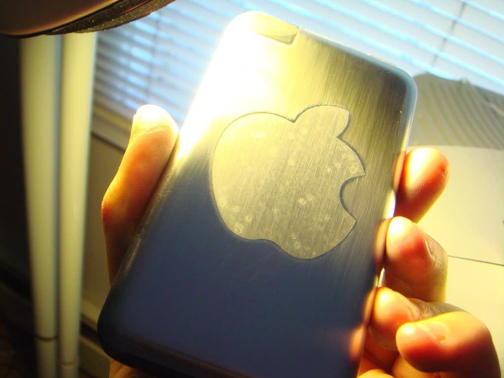

Brushed Metal tut
me the one in the tut looks better
« Reply #13 on: January 28, 2008, 05:05:19 AM »
that one is straighter, and doesnt have a goofy logo on the back.
I may do this to my 5G iPod.
