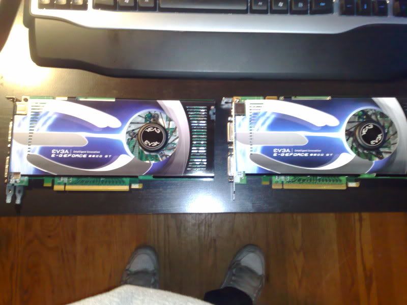

Hello I am process building a new computer for my little brother and he just got 2 superclocked 8800gt for his 15th birthday.  I was going to give him my hand me down 500w Psu, but I dont think its enough to power the cards. If not what is a good affordable power supply? Thanks for your Help  :tup:

someones spolied. and sry but newegg is your best bet for psu maybe tigerdirect. you will probably need several undred more watts it all depends on what the rest of the internals require.

i'd say 700W Minimum, if its gonna be an OC'ed quadcore with multiple drives etc. then 1000w would be a good choice.

Get a 900w or 1000 watt supply and be sure they're good quality.

Thanks guys for all your input! He is going to run a core 2 E6420 probably with a 2.8oc, so I think a 700w psu should be enough? "Yeah I know he is spoiled, But he gets straigt A's unlike his older brother" hahaha Thanks for all your help   :tup:

Lol! 325watts is not enough for 2x 8800GTs.

I was doing some research and saw that the 8800gt only consumes 110 watts.  Here is the web site http://enthusiast.hardocp.com/article.html?art=MTQxMCwxLCxoZW50aHVzaWFzdA==
I guess I was wrong  :faint: Well at least I could power one card and the 500w psu can power the other one right?
Thanks for your help  :tup:
Re: 500w enough for x2 8800gt?
« Reply #15 on: January 30, 2008, 12:16:46 AM »
yeah, but if everything else is going to be good enough to use the 2 GT's, then you will need like 700W, then i'd still go over the top for the next upgrade....
