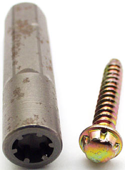

Just google for a gamebit screwdriver, they aren't expensive, and there are 2 formats (4.5 and 3.8mm), I have both.. I used it to open up my snes, and some nes carts.. I believe the N64 uses the same screws as a snes..

This is what I do for the tri-wings in gameboys. Use a really small flat head screwdriver, and put it in one of the the three prongs and push down really hard and turn.  I find it works best to have the gameboy on the floor to do this, so that you can use your body weight to keep the screwdriver from jumping out of the prong you put it in.
For the N64 screws, I've used the melted pen method, it works fine with the right pen, so grab a handful of cheapo' pens out of your desk or something and start experimenting.

I used a pen for my gamecube and for the n64. To melt the pen I used a lighter. Also you want to melt the opposite end that you write with. The one with the hard plastic at the back. The best pen would probably be those Bic round sticks. Just make sure you take the ink out pen before melt. For opening the wii and the gameboy color I used a small flat head (standard?). I bought one of those little screw driver kits and i placed it between 2 of the of shoots.
\_/
 |    Kind of like my terrible ascii pic. I tried putting the screwdriver in one of the offshoots but it would come out alot and i was wrecking the screws. My other method i found didn't wreck the screws as bad. There is 2 torx bit sizes for the xbox i think on is 15 and the other 12 or 13. If you really want to improvise or your doing it at like midnight (Sometimes I can't sleep) and your local hardware store isn't open, use a flat head. The best improvising I think though is using a the outside cover of a cd spindal for opening the 360. I tried it it works pretty good.

I made one for my gba with a flat had screwdriver, just made it a bit smaller with a file, and then i managed to open the GBA,

nice. i cut a precision screw driver i messed up and used a dremel with a cutting wheel to make the grooves or you \can use a file
