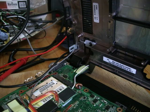

In this pic you can just about make out the external antenna socket.
This part is really a work in progress as the result of testing the new areal are inconclusive right now. I am not really sure if its enough of an improvement to justify having it there. I do seem to be able to pick up more APs in kismet but the streath of the signals doesnt seem to have changed much.
