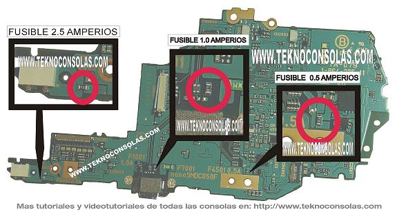

my psp wont charge, i have 2 barsleft on it but when i plug it in the orange light wont come on, ive tried 2 wall charges one car charger and a usb charger. i read somewhere that i blew my 2.0 Amperes fuse but whats that?

if you blew your fuse you can jumper it here is a pic
thank you i was looking for this my friend's wont charge either

Sorry to be bumping an old thread but I am having the same problem, I have 3 PSPs only 2 of them I opened for modifications but now both of them wont charge, the third one seems to be charging fine with all 3 batteries from each PSPs.
I used a multimetre to test the voltage on the 2.5 amp it its getting 5v which i guess was normal im not an electronic expert but it gets voltage so my guess was that it works. But when test the multimetre on the battery metal plates, on the back of the PSP where you insert the battery, it does not receive any voltage. I tried on the working PSP and it receives around 2.5v - 5v.
So with all that being said could this be caused by the 2.5 amp, if so how would I go to make a sort of bridge and jumper it like it was suggested in this thread? :confused:

not tryn to be a noob or anything but wut does jumper mean [sry for bumpin up the thread im having a similiar problemn i rly need help]
Re: PSP wont charge
« Reply #13 on: June 30, 2008, 06:49:48 PM »
If your having a problem your supposed to make a new topic not bring up and old one  :victory:
Jumper=Bridge the fuse with solder  :tup:

sry  :cry2: by bridge u mean connect the the two with a wire? maybe?
Re: PSP wont charge
« Reply #15 on: June 30, 2008, 08:05:50 PM »
Wire is one way,
But the best way is use a condective paint pen.
Radioshack should have them,
P.S. they are expensive but way worth it.
But easy way and cheap if you have supplys is solder over the fuse.
Just put some flux over it and then solder it  :tup:
