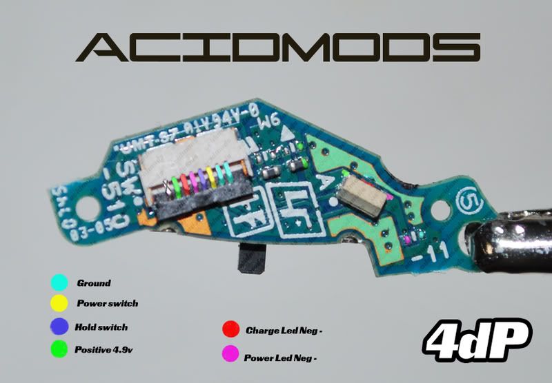

i already grab the pics for psp slim..
take a look..
i want the steady light mod..for the trigger

« Reply #6 on: July 08, 2008, 07:52:48 PM »
i follow the pics above but the light was very slow...
help help!!!

i'm working on the sound mod and found every copper spot on any side of the mobo, power, wifi & led, and earphone/av board is negative.
all you do is find positive and you have the led trigger mod. :clap:

Re: PSP SLIM Trigger LED Modding HELP!
« Reply #9 on: July 12, 2008, 06:47:54 AM »
personnaly i'd recomment wiring to the wifi swich. that way you won't have a dim power led, plus you can keep the hold function. just use the Sound mod tut but completely miss out the part about wiring the sound chip. solder the + wire to the point shown on the tut (it's a small resistor above the analog stick) and wire the wifi swich as you would with the hold swich. solder the ground wire to the swich as shown, put it back together and your done. just done this for a mate. it seems hard but once you've done it, you'll kick yourself for how easy it is.  :tup:
