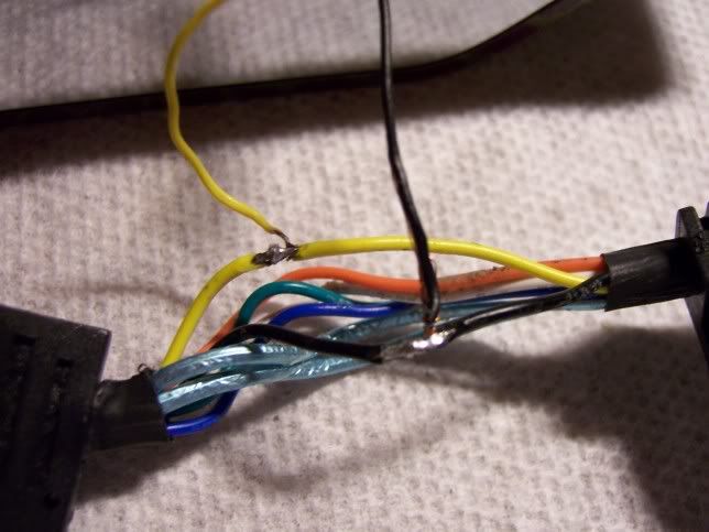

Ok, for the hdd drive i have found this:
You will need to strip the yellow wire(5v+), and the black wire(ground).
its what you did dark_angel???

the way i light my xbox hard drive i went to radio shack and bought 2 blue 3.3v leds and a pack of 47 ohm 1/2 watt resistors and just wire a resistor to the led and wore the positive side to the yellow and the neg to the black for example
(1) 3.3v led and a a 47 ohm restistor
another 3.3v led with another 47ohm resistor
so now we hav 2 3.3v leds and 1 47ohm resistor wired to each of them.
then just place your leds where you want and wire the positives of the leds together and wire it to the yellow wire
next wire your negative wire both neg wires and conect it to the black wire and then test and your done
