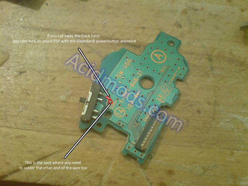

 I saw the tutorial on how to make your psp turn on and off with the music button. I am thinking of doing this but I have a few questions. First, do I have to cut the trace off of the original power switch? Will I be able to turn my psp on and off with the regular switch?

Ya you cut the trace of the power switch on the board and no you cant use the switch  AT ALL unless you connect the trace you cut again if you dont like the note button.
But also you cant use the note button anymore after you do this mod.

you dont have to cut the power switch trace do you? but you do cut the note trace.
Ya you Do.
Full Tut is here- https://www.acidmods.com/forum/index.php?topic=13449.0

yea in that tut is says to cut it to disable the normal switch but im saying that you dont have to cut the trace and still use the power switch as normal and use the note button to power it on aswell. i think.

« Reply #5 on: September 02, 2008, 04:03:56 PM »
Hmm
Maybe the Note button wont power it on?
Ill see ill try on a :censored:ed up powerboard and tell you all my results!
EDIT!
YOU DON'T NEED TO CUT IT!
Just solder to the Top leg of the switch and it can be used from the note button and power switch!
I couldn't believe it would work!   :dribble: :dribble:

« Reply #6 on: September 02, 2008, 05:33:56 PM »
well that's good to know. I still anted to be able to use my normal power switch. Anyway does anyoneknow about the resistor?

« Reply #7 on: September 03, 2008, 12:29:05 PM »
Nice find Jumbo, but there wasnt any reason for it not to work  :eyebrow:
Ya but the tut told everyone to cut it  :winker: So now you don't need to for the people that didn't know lol
