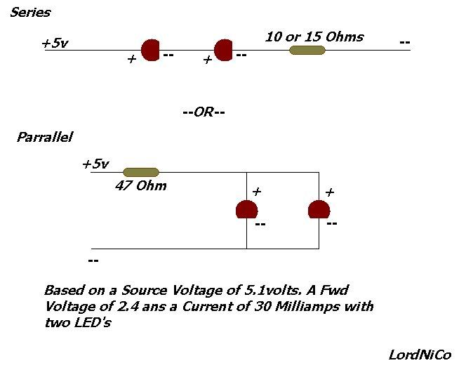

So how are you wiring them exactly, in a series or parrallel? Also what resistor value are you using. Anyway this might help, I wipped it up for you. Guys correct me if I'm wrong but I think that should do the trick. Note that this has been built using a source voltage of 5.1 since the slims 5volt spot has been known to vary. Also the Resistor used in the parrallel drawing should be more like 45 Ohm but 47 Ohm is more common. :tup:

they go parallel with a 10 ohm resistor
anyway thanx for the info ln :)

« Reply #7 on: September 03, 2008, 04:00:00 PM »
I have done that mod before and not had any problem, I figured I would make just a suggestion as I assumed that you were using the 10 Ohm. So That resistor may be to small for Red Leds using fwd 2.4 and maybe that's why yours leds are to bright and burning out. Good luck.
