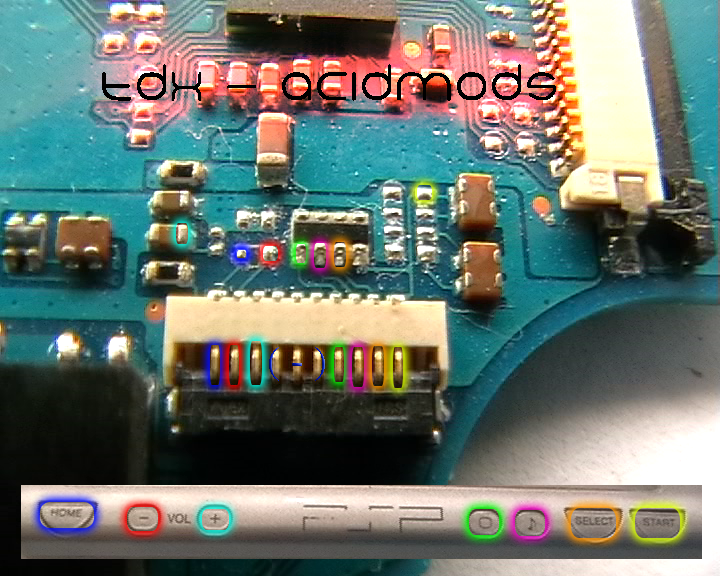

hey people, how do you find the X O [] and /\ with the multimeter i know how to use it just dont know how to do complex thing like finding  buttons. And also where to get some usb male and female before you say its to hard i could solder its takes time but i got the skillz

Search button, there's multiple pinouts for the slim abxy fpc.

The buttons on the PSP are all active low, which basically means that when a button is pressed it becomes connected to ground. To locate solder points for each button you start by visually following the traces from the button contact pads. Part of each contact pad will be the ground connection (commonly shared by all buttons) and the other part will be the individual line for that button. The traces from the ground pads will all merge together, and the traces from the buttons are kept separate.
Now if I am not mistaken, the slim doesn't allow for direct physical access to the button contact pads, so you will have to test from the pins on the ribbon cable connectors. With your PSP powered off, take your multimeter and set it to measure resistance (Ω) or continuity (if your meter has this feature.) You can now determine which pins are ground by touching one probe to a known ground point on the motherboard and then checking each pin on the connector for continuity using the other probe. Write down your results after each test (there may be several ground pins, but they will all be the same.)
To find the individual button lines, push down a single button and then look for a pin which has now become grounded, being sure to not confuse it with the ground pins you wrote down in the last step. When you find it, toggle the button to make sure it is the correct pin. You should see/hear the resistance/continuity reading on your meter jump back and forth with each toggle. Write down each of the pin labels as you find them.
Once you have the pinout for all of the buttons on the ribbon cable connector, you can find additional solder points for these buttons by following the traces on the board and measuring for continuity between the point you want to test and the pins on the connector (the functions of which are now known.)
Good luck with your mod. :hifive:
