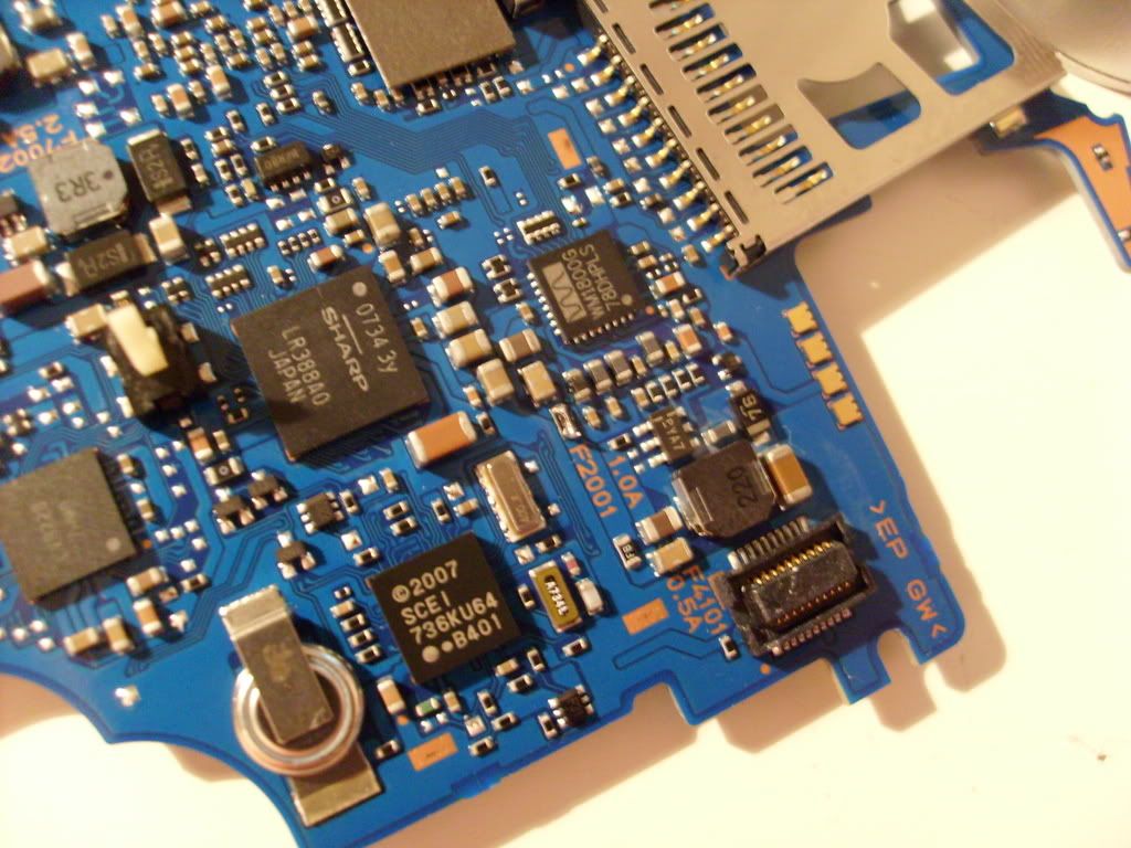

well, I think I managed to bridge the nagger.
need your opinion bout how I did it.
look above the f2001

That's one of the sites I mentioned. Good choice.
No, there's no sound card per say in a psp. In a way you could say it is, but it's not, if that makes sense XD.
Yes, bridging the fuse will shut down the only safety mechanism for the sound, but, it's already BLOWN. That "safety mechanism" is gone anyway. It's blown. Not working. You need to bridge it so the connection will...er...be connected again.
Yes once you get it working it will be good as new and it won't blow, as long as you don't f**k with it any more than you have, no offense. But, srsly, for future reference, never ever ever ever work on something while it's on. That's the only reason that this is screwed up, because you made that stupid mistake.
And, still. I've touched a soldering iron to my fpc cable and it didn't do anything... It's weird.
That soldering job looks fine to me. Now, as long as that's the correct fuse (I don't know where it is so I can't say), it should be fine now.

it should be the right fuse, I found a pic on this forum that pointed to the tiny knobhead.

I'm fairly sure you have the right fuse.
I've heard the shipping from Focal price is around a week or something like that.
A safe way to test it would be turning it on by connecting the power pin with a ground pin on the ribbon connector.
There was a pinout that had ALL pins labeled, including the power pins for the ribbon, but I can't seem to find it anywhere...
It may have been one of those topics that was deleted because it was old.

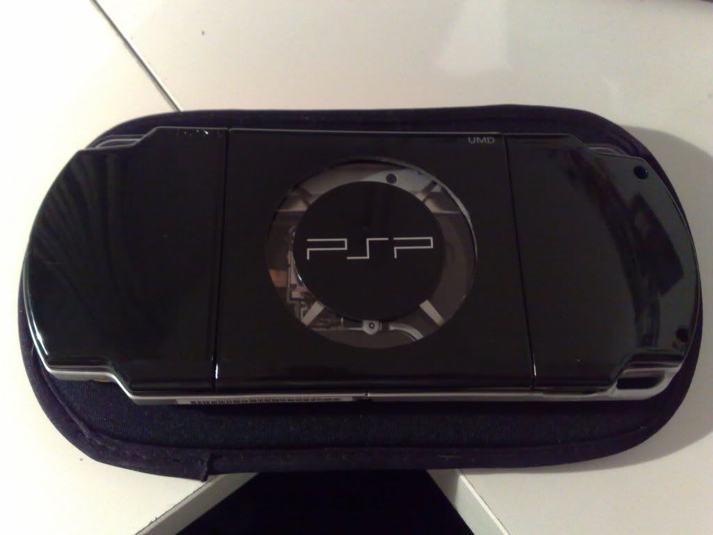

While I was at it, I also modded my UMD door.
no leds yet since the local hardware store doesn't have any SMDs.
well, actualy he can deliver me SMDs, but only with a minumum of 100pcs lol.
here are some pics:

now I have my next question:
I have closely inspected my new übermodded UMD door and found out that it will never ever ever ever have enough free space to fit both a UMD AND a few (2) SMD LEDs including their wireing.
you guys have any ideas on how to solve this? it looks so dull and boring without the ring of light ¬¬

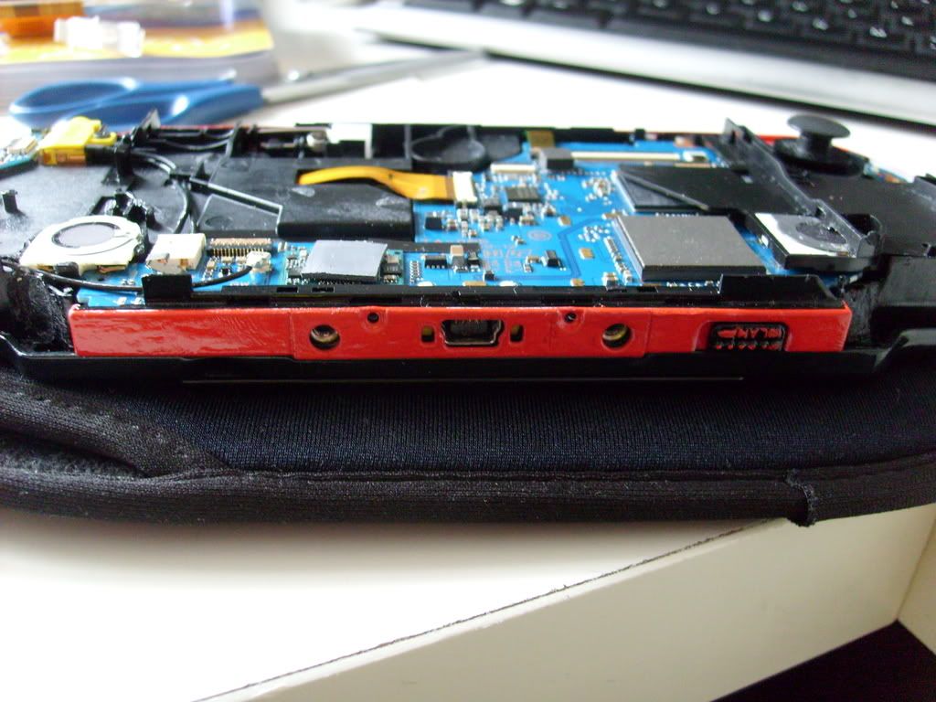

look, I did a small paintjob on my casing :D
well, those are just the buttons, I dyed them black, the rim of my casing is shiny-ferrari red now (need to sand and clear-coat it though)
I left the rest of the casing untouched, it are the details that matter ;)

the wlan switch looks crap, you should probably redo it.
Offline FireFox
  • Posts: 34
yeah, I had to dye it with my precision screwdriver since brushes don't come in a 1mm diametre size lol
have redone it already, just scraped the excess away and redyed it.

here are the pics of my finished paintjob.
it ain't perfect but hey, it's my first try
which 2 do I have to connect to turn my PSP on?
EDIT: found out already. connect pins 5 and 6 with a screwdriver for a second.
CAREFULY, PIN 5 AND 6 FROM THE LEFT!!!
so when you have the hole for the ribbon facing to you, connect number 5 and 6 FROM THE LEFT!!!!!
it will turn on and to shut it down I recommend just getting the battery out so you won't have to touch those very sensitive joints.

coming along nicely firefox. Bit of a print on the paintwork, I know what it feels like to just want to get it all done but a bit more tlc (and wetndry!) on the paintwork and you'll love yourself for it later on!

I know, and it bugged me so much that I repainted it today lol
printless!!!

and I installed the shoulder LEDs (UP AND RUNNIG YAY YAY!!)
