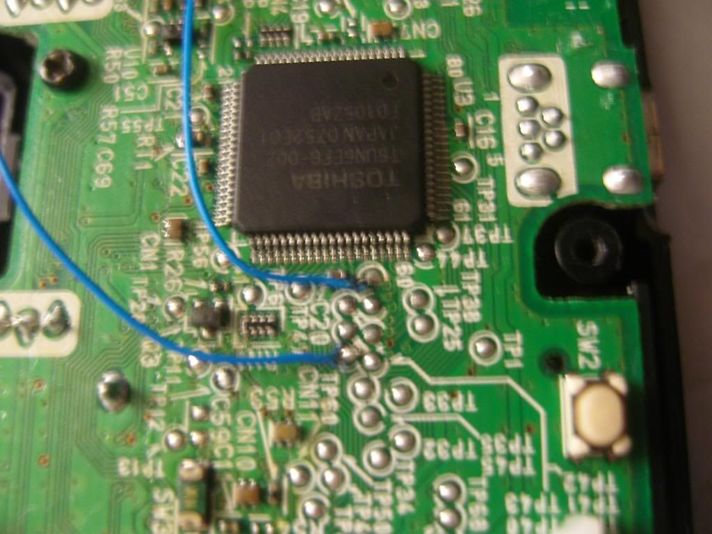

I've managed to get the rapid fire working on my dualshock 3, but not my PS button doesn't work. All other buttons work but not the PS button, the main chip on the board looks fine, none of the pins are soldered together or lifted, any help?
Offline GBlaster
  • Posts: 68
Re: GBlaster's New Rapid Fire Mod [Release]
« Reply #97 on: February 06, 2009, 03:42:52 PM »
I never had that problem but just make sure there isn't anything you missed like extra solder on the chip. Also make sure everything is put back correctly.
Did you mess up during the building process and think you fixed it completely?
Offline Nemesis
  • Posts: 1186
« Reply #98 on: February 06, 2009, 05:22:54 PM »
i have it disassembled, i desoldered the wires going from the chip to the board and i still have the problem.
Offline GBlaster
  • Posts: 68
« Reply #99 on: February 08, 2009, 03:12:51 PM »
Thats very interesting. First time I've heard of it.
Can you send a picture of the board?

Offline Nemesis
  • Posts: 1186
« Reply #104 on: February 16, 2009, 12:14:20 PM »
Sorry it's blurred.
« Reply #106 on: February 20, 2009, 03:10:11 PM »
Uh how can you be so sure that it's the physical home button? What if it was the FPC? Also it's not as easy as you think it is...
Offline Nemesis
  • Posts: 1186
« Reply #107 on: February 20, 2009, 04:46:21 PM »
I only have a picture of that area as that is the only place that i soldered that would have affected the buttons. The connector where the flex cable goes into at the front of the controller has not been tampered with at all.
« Reply #108 on: February 20, 2009, 06:53:44 PM »
Yeah but ndru was saying how you should make your own button, and that's really a dumb idea...
