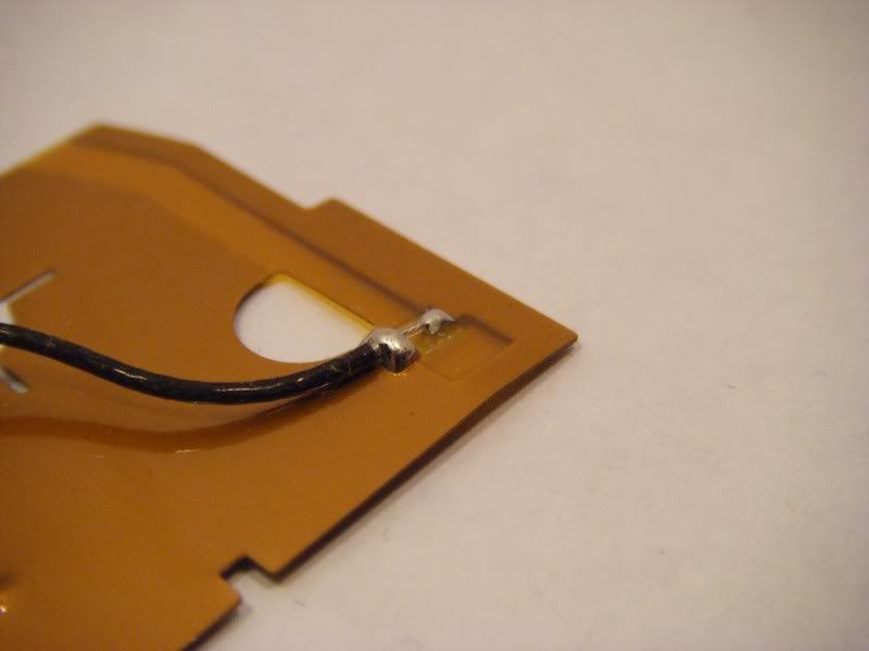

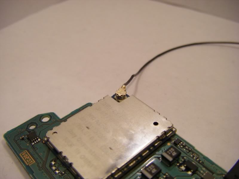

Okay I want to do a mod that has an antena connected to my psp that is hooked up to the wifi wire to get better wifi signal, I need some understanding about the wifi hardware, I have psp 1001 model and the wire leads from the chip in the left bottom to the middle right with a weird bulb at the end and is also connected to a gold foil like thing, what is that all about? Can I do this mod? Or is this imossible?
EDIT - Here are some pictures

the silver bulb is just a blob of solder. The wire and the gold foil are the wifi antenna. This is possible because I saw a guy on youtube do it. He simply took the antenna and the connector out of a wireless router and connected the black wire to it instead of the gold foil piece.

The connector on the wifi card is a U.FL, you can use a U.fl adapter pigtail or directly connect a U.fl antenna. Those are the two easyist ways.

Here's another question, if I switched for another wifi cable thing, will I get better performence? I found the site where that guy posted where he hooked up his router's wifi antenna to his psp and he got 10% increase and no drops, when he was testing the old origional wifi antenna just dropped connectivity all the time. If replacing the switch is not worth it then can I cut the gold part untill I only have that little transparent line that the wire is connected to? Or is the whole gold foil like piece the antenna? Thanks!

Linksys routers have disconnecting antennas, not wires. The wires inside are soldered. So you would need the pigtail to solder on with the wire, and then yes, you could use it. I found the pigtails on 4 inch wires for about 3 bucks a while back, but lost the link during a format. I did a wifi antenna mod using a D-Link gaming router antenna. It was connected with the U.FL connector inside, so it was a matter of wire hole, and mount, so it was simple. Click this to see my antenna mod.
