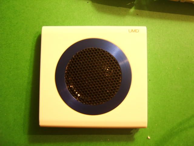

If you want to do internal photofast, and a speaker to go with it:
Get a singing birthday card from walgreens or other drug stores if they have them. They are thin, and loud. If I could provide you with a link to those type of speakers, I would.
This is how I did my speaker so that photofast will fit also:
1. Dremeled a hole out of the UMD door that is a little bit bigger than the metal ring.
2. Placed a new ring on the door.
3. Lined up the speaker from both sides of the door, Mostly from the outside so I can see if it was aligned with the ring.
4. Used hot glue to hold the speaker in place
If you do not understand what it should look like from inside, I will take a picture for you
« Last Edit: December 31, 2008, 06:59:36 PM by RoBot1ks »

i did not know that they weren't spring loaded. as for the usb problems, it wouldn't need to screw with the usb jawn, i took measurements and it would sit on top. regardless of that, i decided not to do the slot idea, i would but i guess since it's not spring loaded it wouldn't work. :sadno: tnx for stopping me before i cut up my case for no reason.
that speaker job looks really nice, i like the grill but that's not what i'm doing. i might borrow that that gift card speaker idea though, as long as it can hit all the highs and lows (if i do i'll give you credit :hifive: .).

Yea man no problem. I liked the grill idea and its white now but I will be showing that in my final product for the mod off.
At the time the grill wasn't perfectly cut. I had a little more grinding to do.
