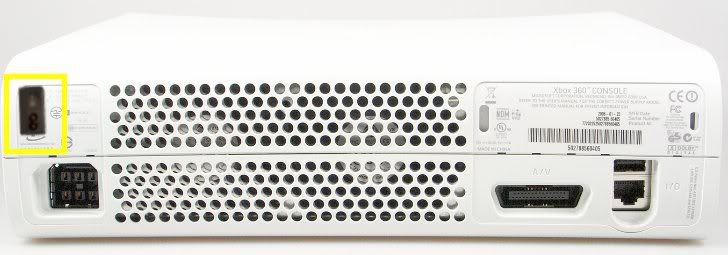

Hey,
WARNING: attempting this mod could result in serious injury or death, it is just an idea. DON'T try it
I was just thinking about an extra power source to light up or power all your mods for the 360 and came up with this:
I will be using the figure 8 power lead like the one used for the PS1:
Now onto the 360. Since there's a little bit of space in the bottom right corner as shown in the picture. (The red rectangle indicates the area available and the yellow is where I will be able to drill). I was thinking of drilling some holes and fitting the adapter or connector or whatever its called into that hole.
Xbox 360:
The adapter:
Once that is installed I expect it to look something like this (please excuse my REALLY bad editing):
Now for a small circuit board to fit along the grey air vent panel, a few pads to be able to solder whatever you need:
So what do you guys think ? I know its just early days and planning. But I think it could work well. Please comment.
Thank you
Max

Re: Xbox 360 case mod solution for overheating/banning
« Reply #1 on: December 13, 2008, 08:57:50 AM »
It would work.
But I think having the cable like that is too much power...
This wouldn't be deleted, why would you think that?

« Reply #2 on: December 13, 2008, 09:00:53 AM »
What about like a 12volt one ? I dunno in the sticky above Fufa said he would delete any posts about external power sources for like fans.
« Reply #3 on: December 13, 2008, 09:23:48 AM »
This is a mod idea. It won't be deleted. Besides, *Fufa is never active anymore.
Still a good idea, and I think 12v would be better.

« Reply #4 on: December 13, 2008, 10:27:46 AM »
You have to make the AC into DC electricity or else you wont be able to do any useful mods.  The converter is the bulky part that converts 120V AC (220V in Europe as ur picture would suggest).  The power brick on the 360 is just an example of an AC to DC converter.  A common solution is to use a "wall wart" or a converter that plugs into the wall.
If you internalized a wall wart you could use that idea, but they are bulky and can produce a lot of heat, depending on what you hook up to it. Also, the wall wart will rate the amount of current that you will be able to source from your new supply.

« Reply #6 on: December 13, 2008, 04:42:22 PM »
hmmm, yeah I was thinking of like using a phone charge or the PSP one...but that would only limit the mods to LED's. Wouldn't be strong enough for anything else.
802Chives:  What if I modded the PSP adaptor to allow a little bit more volts through ? ( I don't know how to do that anyway, maybe you guys would) But it would still be AC....What about a transformer ? Like a low voltage one like this:

« Reply #7 on: December 13, 2008, 05:26:37 PM »
That's why you use a charger or power cord that is used for something that requires more power.
Like, a psp charger outputs 5v I think.
DS charger outputs 3.3v I think.
Use a charger or cord/transformer that outputs something like 12v.

« Reply #8 on: December 13, 2008, 11:00:40 PM »
I just asked my friend and his laptop charger is 5a 15v input AC and 14v 5a DC output. Would that be OK ?

Yeah thats what I intend on doing. 12v DC power supply that or a 5v one like the PSP charger. I was just putting the idea out there. Just for the sake of it, maybe it might help someone. Personally if I was going to do this I would get the 5volt PSP charger and just use it to power LED's

Well, if you only need a 5v source, I would think a mini USB female port could be used to hook up either a Motorola style phone charger, or a Male fullsize USB to Male mini USB cable from the back USB port on the 360 itself if it were just led mods... I don't know about the amperage supply from the onboard USB ports. Just food for thought.

I have partly read through this thread, but I feel I must comment.
Max, I wouldn't recommend you try any mods of this nature until you have a better understand of current, voltage and the consequences.
30 milliamps AC could kill you.
200 milliamps DC could kill you.
You will be working with higher amperages..

personally, I liked the origional idea of this thread, using an external switched power supply. this could get dangerous if in the wrong hands, but in the hands of a skilled modder this has limitless possabilities. honestly, I've been hit with 5v, 12v, and I have had a dose of 120v. and am still kicking. the best thing about these lower voltages, is when they bite you, they let go, when you get up to 110-220v these grab hold of you.
kids please dont try this, this mod I agree should have lets say a 18 yr age limit or so, but I would not just look past it, you are working around these voltages when working inside the xbox anyway,
just make sue to use a selectable transformer, like the one I listed from radio shack, this way once the power gets to the xbox, it is the same as the usb anyway.
so realistically, this is not any more damgerous than  A. plugging the 360 into the wall, or B. soldering to the usb or 12 power source of the 360.

I disagree..
Plugging a 360 into a wall is alot safer, it is a professionally engineered device, not a socket cold-soldered into some leds and a 360. I'm not going to argue, electricity kills, end of.
anyways..
Sorry to burst your bubble, but ndrew did this mod aaaages ago.

Hey ease up man, everyone has to start somewhere - Here's a diagram to help you out:
All you got to the is cut the circuit and then just add a switch to to connect it up again.
Hope this helps
Max
P.S. You better not be trying to do this mod.

Sorry about being so harsh, playing with electricity can be dangerous!
An example, if you had attempted to install a socket in your 360, wired up the leds with 30 AWG kynar wire, and then plugged the socket into 240 VAC, you know what would happen? The wiring would almost certainly catch fire. You were smart though, and posted here first.

Yeah I thought the power cable only supplied 12v, coz I saw one used in a radio. But then I figured out that the radio had something inside it which only used a certain amount of power. But I wasn't sure what. So I posted on here. I'm not a retard lol, I'm not that stupid to try pump 240v into 30 AWG wire, it would disintegrate. But again if i were to do the mod. I would just use the USB port as mentioned before you. That seems like the best and safest way.
