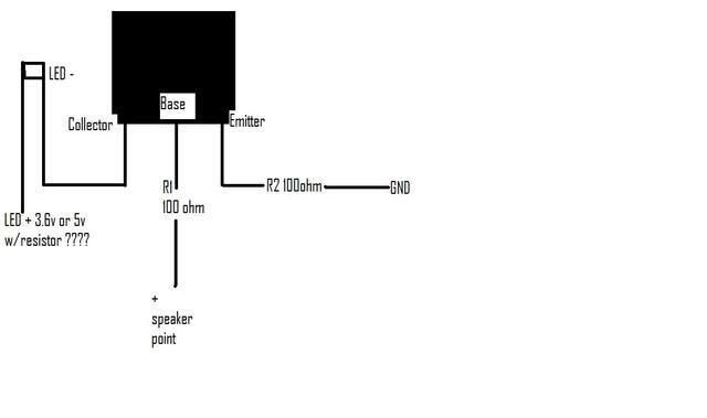

« Reply #35 on: January 09, 2009, 01:53:51 PM »
another thing is there always on but it looks good
anyways i will get a diagram up of how i wired it so maybe u guys can help me out
THANKS

« Reply #37 on: January 09, 2009, 03:26:37 PM »
kool
and i know that diagram is wrong i was in a rush ignore it

« Reply #38 on: January 09, 2009, 03:39:35 PM »
THANKS
By the looks, im guessing it should be 5v instead of 3.6v
And wouldnt you connect the speaker to the base, to open it?

Re: Sound Reactive leds REDONE
« Reply #39 on: January 09, 2009, 10:13:37 PM »
that is wat i did the speaker to base wit 100 ohm resistor
led - to collector
and gnd to emitter wit 100 ohm resistor
and led + to 3.6v i will try 5v and see wat happens i hope that helps

« Reply #40 on: January 10, 2009, 05:48:32 AM »
led - to collector
Would it be able to amplify an additional speaker with 5v? Im going to try it anyway

« Reply #41 on: January 10, 2009, 06:30:26 AM »
The transistor wired in that way wouldn't power a speaker properly.

« Reply #43 on: January 10, 2009, 09:14:43 AM »
can u help us out here alien since ur like the master of electronics  on am
EDIT:
i had time so i drew up the diagram but correctly this time and remember this if for the sony amp idk how it works for the normal psp speaker outputs but u can try it if u want i might EVENTUALLY
EDIT agian:
i tried it on the 5v and it is super dim doesn't even react well
wat i think it is is the amperage cuz i checked the amps on the 5 and its like 50+ and on the 3.6 its like 220+
another thing is that when i connect multiple leds it doesn't really get less reactive but dimmer making it look less reactive if u get that
Well there is a limit to how much voltage can be supplied across so many leds - they are almost certain to get dimmer the more you put on.
« Last Edit: January 10, 2009, 11:59:53 AM by j.s2ghetto »

« Reply #44 on: January 10, 2009, 12:29:34 PM »
Problem solved
instead of connecting base to gnd i connected it to the - speaker point and its beautiful off when no music super bright very nice also no need for the 100 ohm on the - speaker point i will be experimenting wit this way to see wat how to get the best results thanks to everyone who helped

« Reply #46 on: January 10, 2009, 08:15:55 PM »
on mobo right or top bad i think but i could be wrong
but i made a mistake on that the negative doesn't go to the base it goes to the emitter everything else is like it is on the diagram but remember this is for sony amp not mobo so it might need tweaking for it to work its best on the mobo and this might be able to be made to work better on the amp but idk i will experiment on my psp for now i need to finish this so thanks for the interest and help guys really apreciate it
