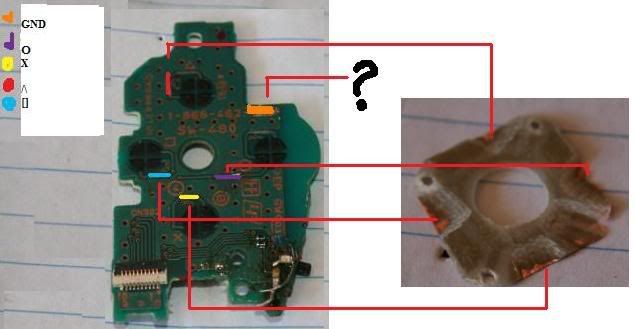

so guys i just want to ask if this connections is right...
and i want to know where the GROUND should be soldered on??
btw i'm using spare analog with this mod..thanks guys..

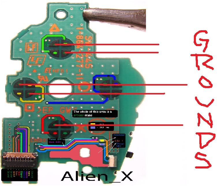

The WHOLE green panel is a ground (apart from the 5v/3.6v part)
so my wires are correct??
so i can place my ground on the green panel itself?
you're referring the green panel as the board itself right?? :wacko:
Pretty much all the board, apart from the contacts and a small area of the panel

« Reply #4 on: January 10, 2009, 06:26:19 AM »
so this where i can run my ground points??

« Reply #5 on: January 10, 2009, 06:28:26 AM »
Yes, but those points are connected to the huge solder-masked area around the buttons - you can see they are visibly connected.

« Reply #7 on: January 10, 2009, 06:44:04 AM »
You could always solder to the back on these points-
I use these points for dual nub, Looks cleaner :D

« Reply #9 on: January 10, 2009, 08:22:43 AM »
so the ground on the front i will solder it to the ground point at the back of the board??
is that right?
If you mean that they are the same points, yes
as Jumbo said, if you do it on the back of the PCB, its a lot neater, plus nothing gets in the way of the buttons (so the buttons don't lose sensitivity or feel weird)
