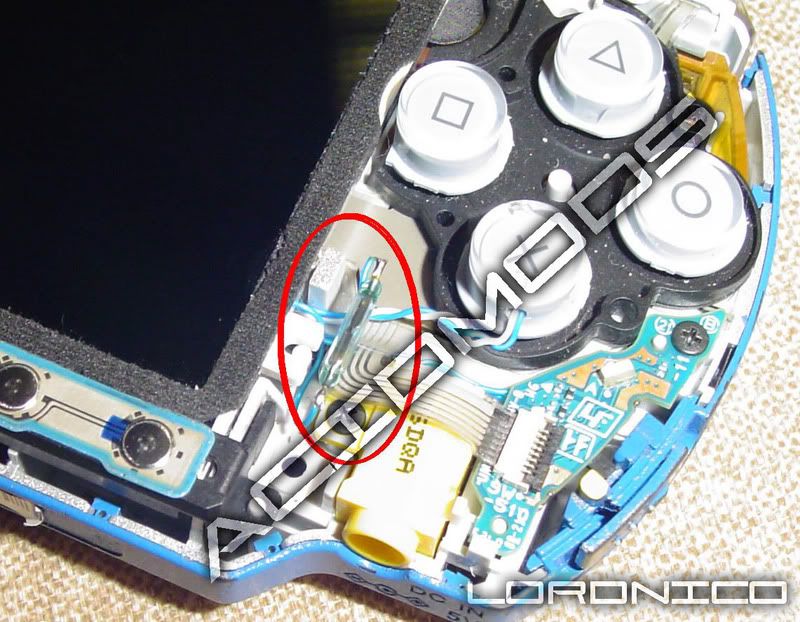

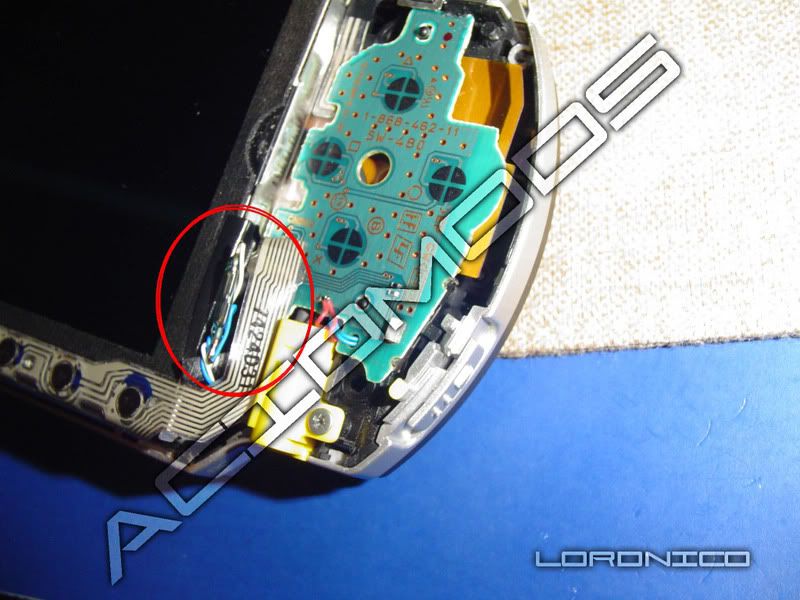

So this will be the same for both types of PSPs but I’ll include pictures.
1.   To install the switch take 2 pieces of Kynar wire of equal length about three inches or so and strip the ends of the wire.
2.   Hold the two pieces of wire together and twist then so that they look like this, also It will help your install and make things look cleaner.
3.   Then solder the wire onto the ends of the reed switch. (I would normally use heat shrink on the exposed endpoints but I was out of it when I took the pictures. So I will apply tape to the areas around the switch).
4.   Next you will solder the wire onto the power switch
5.   For the slim solder the wire here and here.
6.   For the Phat solder the wire here and here.
7.   Then install the power boards back into the PSP
When installing the power boards you want to ensure that the new wires you just installed are not going to get in the way of the existing charger port wires when reinstalling the power board. Also you are going to be installing this new switch parallel to the lower right hand side of the LCD screen as shown here.
NOTE: if you don’t use heat shrink on your endpoints put tape on the exposed metal surfaces to prevent shorts!
8.   Put your PSP back together again but don’t install the face plate yet.
9.   Make sure that the contacts in the glass reed switch are horizontal. Then place your battery in the PSP and using a magnet wave it above your new reed switch. The PSP should power on.
10.   Turn off your PSP and make any final adjustments to the reed switch so that the reed switch is as close to the face plate as you can when you put the face plate back on, without interfering with the LCD screen or the buttons.
