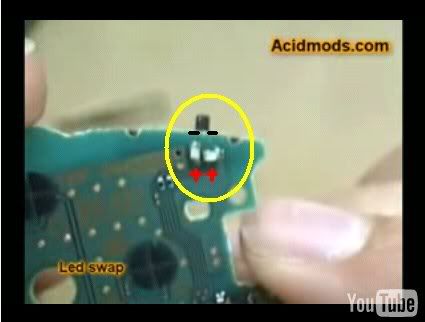

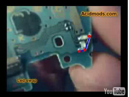

so again before i do the led swap mod i want to azk you guys again for your
expertise on this one :tup:
is this correct??i want to know which side is the + and - is...
and second, is this right way to bridge this??
thanks guys :tup:

    The small traces that goes from the 2 resistors to the leds are known to be the (-) side or contact points. The larger area almost underneath the leds is known to be the (+) side or contact point. From the (-) side of the leds both leds will be solder seperate following the small traces and from the (+) side of the leds, both will be solder to the larger area together. Its not really bridging but linking both (+) sides together. Good Luck...

that means the pics that i did is not correct :tup:
i'll just change and reverse it...thanks man :tup:
