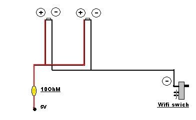

i have evry thing to do the umd and trigger led mod i have look at just about evry tut can some one please tell were the exact spot to solder so i can turn them off with the hold or the wifi switch.(i have a phat)and were can i buy the umd jewel from :hifive:

You can get jewels from the acidmod jewel shop here, https://www.acidmods.com/forum/index.php?board=381.0.
As for where to solder, i would recommend using the wifi swich. i never understood why people would want to lose there hold function. still, each to there own i suppose. ok, i don't have a photo but this should help you understand where to solder.
Just bridge the closest two pins on the wifi swich an solder the ground wire to the last pin that stands by itself.
If you have any questions please ask :)

first off thanks for your speedy responce.Those jewel are rad going to get one.Ok Im sorry if this sound stupid i understand the wifi switch kinda.what do u mean by bridge and second .pos wire were is v5.Ha all this  electricial stuff is all new to me but i love doing it and to see how it turns out.Last thing could i run another led to the umd door and would hace to add another resister.thank :hifive:s
Re: psp phat mod help
« Reply #3 on: February 12, 2009, 01:30:45 PM »
You can also get jewels from shatteredmods.com :tup:
As for bridging, he means connect the two pins together, whether it be dropping a blob of solder, connecting it with a piece of wire, etc.
5v point is here circled in red:
and to add another led to the umd door, you could connect it to the same resistor.

Yo thanks for all your help i"ve asked alot of question and i"ve got alot of nothin like i'm wasting alot of people time.So atleast im boing in the right direction thanks again.Will i still be able to conect to the internet once i do this bridge

yes. Thats the point of the bridge. It allows the psp to have it's wifi active no matter what position the switch is in, on or off. With the LEDs wired the way of the first diagram, the wifi switch provides a ground for the LEDs. The LEDs will come on then the wifi switch is in the off position (down).

     YES...The point of bridging the two closest wifi pins is so the wifi switch would remain contantly on and allow you to turn (on) and (off) the switch for the purpose of lighting the leds. Don't worry, this wiring set up will not harm your psp or the internet connectivity.

I did the trigger mod i asked about were i used the wifi switch to v5.Know i would like to run 2 more led to my umd door how whould i go about that could i just do the same thing sodder 2 more led two the same point and do i need another resister and are differnt colors stronger then others.
