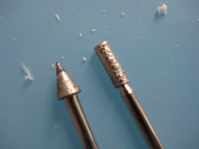

with these dreamel bits
When your done it will look like this
