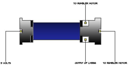

« Reply #11 on: March 07, 2009, 04:36:58 AM »
so heres my diagram...will this work?
and can you tell me where to connect the wires to my reed relay..
thanks guys...

« Reply #12 on: March 07, 2009, 09:38:37 AM »
Well that looks like it would work since its the same circuit as this one
As far as which pins on your relay, it looks like the 2 bigger contacts are your coil and the two smaller ones are the switch contacts.

« Reply #14 on: March 07, 2009, 07:43:02 PM »
which of the two of the rumbler connection leads to positive and the ground
is the top rumbler connection is the positive?
Awilliams357- to be shipped

I believe to have the hookups on the reed relay wrong. The - lead of the rumble motor should go to the ground . Therefore there should only be one pin on the relay that goes to the motor.
One of the pins of the relay needs to be a ground to allow the relay to function.

Yeah I think my diagram is wrong described.  Polarity does not matter on the relay.
I'm not sure how well that relay would hold up though, since it will be openinig and closing its contacts hundreds of times.  Anyone run this setup already?
« Last Edit: March 07, 2009, 11:28:27 PM by rgarjr »

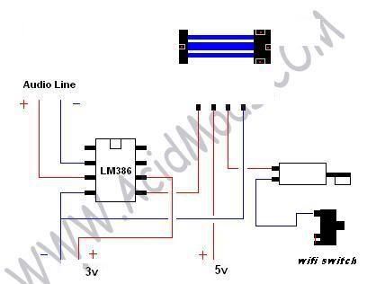

can someone post the right diagram..
thanks..

« Reply #19 on: March 08, 2009, 12:32:47 PM »
Hopefully this one should get you going on this mod.
resistors on the lm386 imputs?

« Reply #21 on: March 08, 2009, 08:48:33 PM »
It dosent appera that any are needed. The original diagram dosent have them either.

« Reply #22 on: March 08, 2009, 09:35:03 PM »
hmm, thats weird. Lm386 should handle it I guess?

« Reply #25 on: March 09, 2009, 02:43:29 AM »
hey ghost is this diagram your saying will work??
thanks rgarjr for the diagram...
i hope this help me finish my mod..
