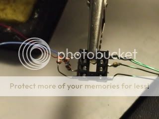

CG sleeper:
cg on button:
matrix sleeper:
matrix on button:
solder all components to the pic socket

lol, I feel like such a nub. I have modded several of these, now I just did one on the matrix, eveything works dandy execpt when I turn on the rapid fire it doesn't require me to press the trigger, shoots at that speed by itself, then when the trigger is pressed it stops firing. Wtf it works the opisite than its supposed to, like its been inverted, any ideas?
OH btw soldering is fine and everything is wired correctly, code also programed fine. I was also recording a video tut for this thread at the time so its a bit of a fail.
« Last Edit: June 09, 2009, 03:02:07 AM by GhoSt_Death »
Re: how to use free open source code by HAZER.."burnmeup2"
« Reply #20 on: June 09, 2009, 04:34:34 AM »
dont feel bad dude, its not your fault... this has beenposted for a while and you are the first. I am not going to go through the normal responces with you as I am confidant in your skills. you will notice in the tut notes, I stated that there has been some trouble with some of the matrix boards, not all of them are created equal.
what you are describing (auto fire, and stop fire when pull trigger) leads me to think that your frequency is too high thus signaling rapid fire, and when the trigger is pulled it goes even higher thus overloading the controller and registering as a hold. thats basically how rapid fire works, you hold the frequency at just the point before the trigger pot regesters it then the added trigger pull makes it fire, and the pulsing keeps it going. make since?
so with some rare, and very few MATRIX controllers you need to increase the resistance from 330 to a higher resistance, you will just need to experament with it a bit until you find the correct resistance. another solution would be to wire 3-1N4148 in series to create a Zener effect, thus limiting the pics output. please play with it a bit, and let us know where it ends up. I have never had this problem myself, but it has been reported in the past.
once again thanks hazer

yep im going to swap the board with another matrix. Here are some pics of the controller mobo just for info. Could help someone identify theres.
links because of size.
http://i44.tinypic.com/167rntc.jpg
http://i40.tinypic.com/kc1jie.jpg
one on left is standard matrix, one on right is the Un-rapidfirable xbox controller (UFC).
http://i40.tinypic.com/2i2afkl.jpg

Just to clarify: The only difference between those two controllers is where the potentiometer is when physically linked to the trigger. Most of the time, the 330 Ohm resistor is matched with the resistance of the wiper when the trigger is pressed. Every so often, theres a resistance that is off from the norm and requires upto a 1.5k Ohm resistor.
