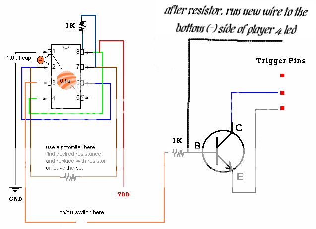

dude this schamtic of yours
with the LED indicator light ridge to the 4th payer is AMAZING i was wondering when i first saw your first schamtic if you were ganna make an indicator.....

i need to know though i got a different 555 timers ( xc ne555p) does it matter? i know ive seen someone ask, but i skimed that cause it really didnt get any of my attention ...though i think i should read back and see..
will it matter cause the one you indicated to get from retardshack is a tlc555 chip...i hope not cause i busted some chips taking them off an old learning set a friend of mine gave me years ago and one of them was a tlc555 chip :cry2:
and oh i definatly need to get a switch then... i got myself a momentary switch for $4 something from harborfrieghts(all perpose tool store) thinking i can use that as a switch unitl i reviewed the thread post and the scheme..so yeh i might need to get an push switch thats nomally open ... wouldnt be a big deal im on a cheap budget cause of no cash flow... its cool if not ill see if i can rip out a push botton from my computer parts that arent in use  :huh:

now to answer your question, it defiantly matters!! the tlc555 timer is a low power timer. the other is not. the TLC runs at2.5-3.5v and the other run at +5v. I tried using other timers by adjusting the caps and what not, they will work but they are not consistent and sometimes dont work at all which really sucks while playing.
