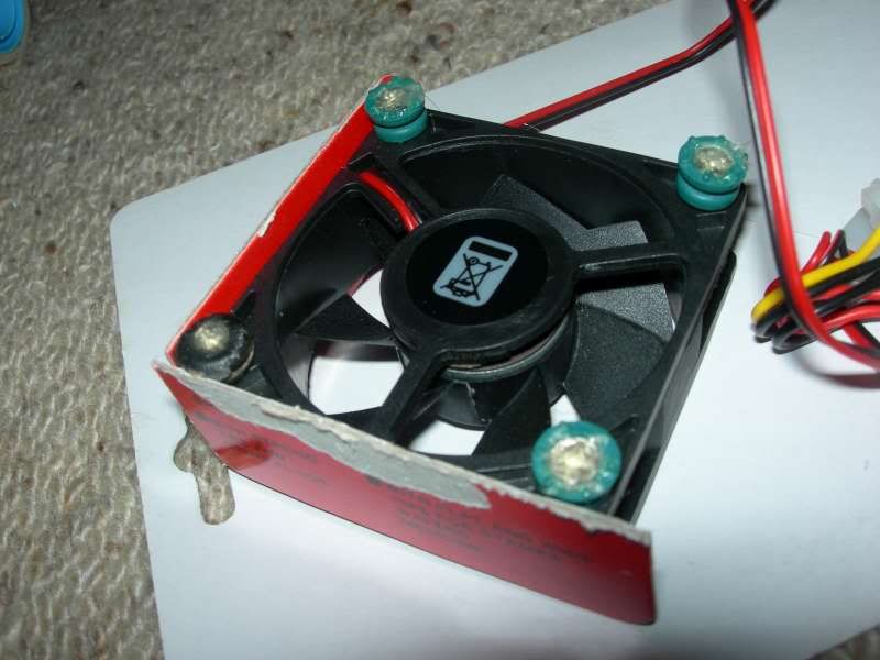

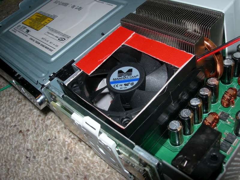

First Im starting work on the extra fan, getto fan chutes, to increase effiency and allow more air flow to the gpu.
working that cardboard
fits perfectly. (gona cover that orange stuff)
will be updated.

that looks like a Xenon board (one of the first) and I cant see it but it looks like by the placement of the heatpipe inside the heatsink it has been sent to the microsfot repair shop already!! directly under the fan you put in there should be a signature or two of the repair tech, it would be nice to send him an email telling him his repair was wothless.
have fun, modd the crap out of, dont be pissed when/if it RROD again. (sorry dude thats just how it is)

omg! that fan fits perfectly

« Reply #6 on: May 07, 2009, 09:49:15 PM »
Im pretty pleased too, 60x60 mm is a perfect fit.

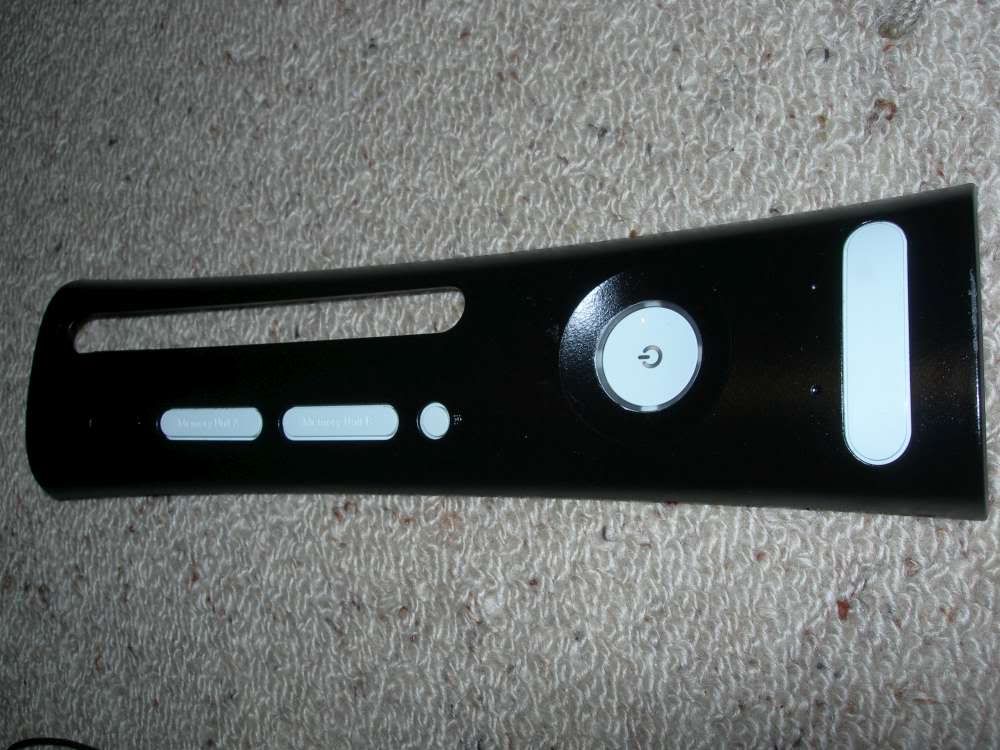

edit: finaly did the paint job, installed plexi and air vent mesh. Built up the lighting strips.

« Reply #10 on: May 31, 2009, 05:23:28 PM »
Oh, GOD that is AWESOME LOOKING so far.
