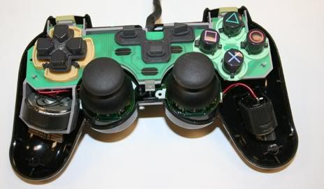

This is the insides of the SIXAXIS
This is the insides of the DUALSHOCK 3
Hope that helps.

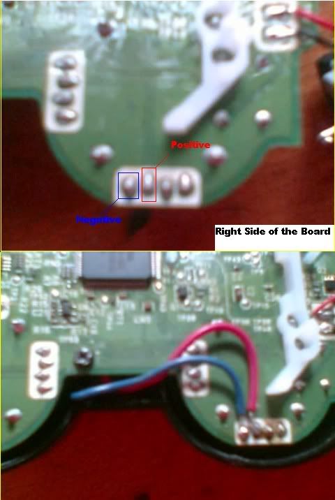

If i was to add a 3 mm led under the PS button..
Has anyone got any pinouts For both controllers with where to wire the positive and negative connect to..
cheerrssss..  :tup:
Offline TwisTtheTwiTcH
  • Posts: 782
  • Post quality +12/-2
Re: PS3 Controllers...
« Reply #8 on: June 28, 2009, 12:11:05 PM »
Here you are. Hope it helps.
Also check this out, took screen shots from it. Tried it, worked fine for me.
Dual Shock 3 LED PS Button Mod Tutorial
-TwisT

« Reply #9 on: June 28, 2009, 01:07:17 PM »
Thanks :D
Is it the same on both sixthaxis and dual shock ?
Cheers :D
  • Posts: 782
« Reply #10 on: June 28, 2009, 01:22:53 PM »
Yes, 99.9% sure. Hope all the info helped you out Ben.
-TwisT
