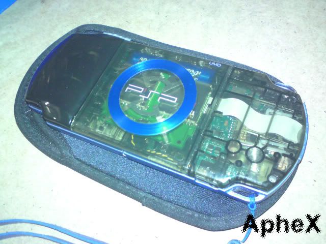

These your own images?
like i said at the top i'm still in the middle of making some up. the smoke clear psp is mine, but the other pics are from bense, so credit for those pics go to him (untill i finish the rest of mine that is, lol)

nice ima do this to its pretty cool where did you get the blue ring on umd door
i got it from the blue case you can get from DX. just swapped the trim and the ring on to my black smoke case.
