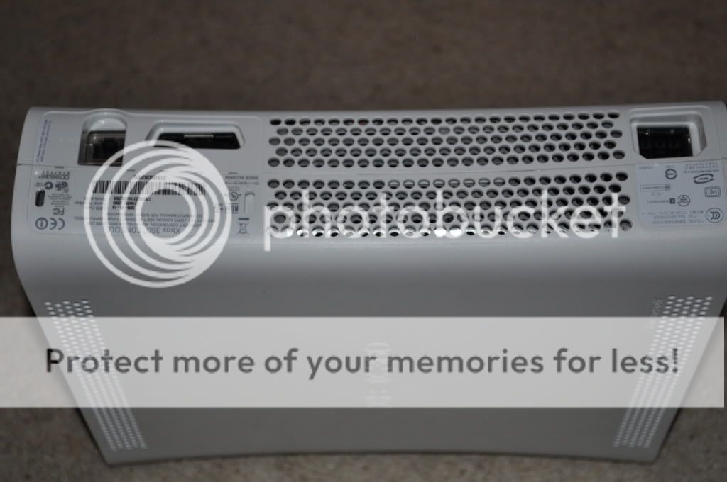

when i turned it on for the first time it came up with 3rrod error code 0020
couldn't find a diagnostic, may just be me being blind :P
then i turned it on while holding the sync button accidentally and it worked :D
only problem is the dvd thing wont eject :/
i can here gears turning etc. but it sounds like its stuck.
it opens when i open it manually so i think its something wrong with the gears, any input on this would be great, thanks.

pics up

If you got the 3 rrod once sooner or later it will come back. Maybe you can add a fan or do the 12v mod trick. That might help. As far as the dvd drive you can get another drive and spoof it the new drive. Take a look at jungle flasher for a tut. Or you can try to buy the same drive and swith the baord? Can't wait to see the your end result..

« Reply #4 on: October 06, 2009, 04:26:00 PM »
Get a VIA chipset sata controller.
Backup the firmware on the drive using JungleFlasher
Get a BenQ drive
Spoof the BenQ as the original drive and flash it with iX1.6 and the original key all using JungleFlasher.
Then you've got a fully working [quieter] drive that can even play backups.
0020 GPU Malfunction, similar to error 0102
0102 needs the xclamp fix, so I recommend trying that since it's pretty cheap.

here is the acidmods tear down tut if you need it, I will have the xclamp tut done by friday. lol

so the xclamp will hopefully fix it?
btw rrod came back :/ new it could last  :huh:
think i'll buy a x clamp kit from treemty and have the drive flashed by blackburn.
