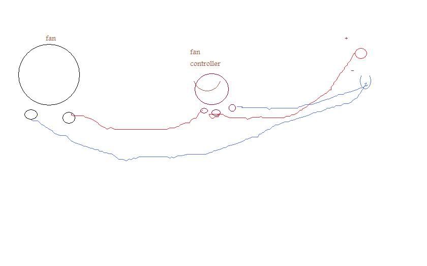

ok so i've never hooked up a fan controller ,Rheostat ect before so i need a lil help with the wireing up of it or a diagram if anyone has one laying around or could make one. But i got this at Rat Shack today its what the guy said i needed to control the speed of the fan (hopefully they were right cause its a blizzard here and i don't wanna go back out LOL) but anyone who can help i thank you very much just basically need to know how to wire it into the fan and that

Wire your source line to the middle pin and either of the side legs to the fan.
It's basically a potentiometer. If you can't wire one, you're best not bothering.
You could've used something smaller and easier, like a small potentiometer instead of a rheostat. You just need to make sure it's rated for the power you're working with..

i told the guy it was going to be coming off a 12v spot and he said it would work LOL would i need to ground it too though
« Last Edit: January 01, 2010, 12:19:27 PM by krazyone2006 »
Re: ok so you can say this is a noob question LOL
« Reply #3 on: January 01, 2010, 12:31:06 PM »
No. You don't "have" to, but you could wire the other terminal side to ground to reduce noise (I think).
Yeah, this will work fine, I'm just saying you could've found smaller pots that could work if you tried lol

so basically wire it like this sorry it looks like a kidegardner drew it but did it quick in paint LOL

best drawing ever :)

Basically.

ok that didn't work the minute i turn the 360 on to test it i get the rrod but if i disconnect the fan and start the 360 it boots fine any idea anyone LOL

ok well  since its three, im not sure if it was 2 i could tell you. However what im thinking is that the pins  could be touching a peice of metal in the consol. what i would do is try using a pot instead like kicks said. Also what im a little confused about  is why you have the ground connected to one of the pins on the controller, cheack the back of the package it came in to make sure its connected to the right pins.  if still getting the 3rrod  diagnose what the error is using  the method stated here https://www.acidmods.com/forum/index.php/topic,21654.0.html

You didn't seem to read.
You can (as per wikipedia) connect one terminal to ground to reduce noise on the signal line.
There's no "controller" here either.
He can't use any old pot either. He needs one rated for the power he's putting through it.
Krazy, disconnect GND and try it to be sure.

mk kicks not to start anything  but as he stated before on his diagram it is listed as the fan controller that is what i am going bye here. as for the any normal pot that would have gone without saying.  however as for the  ground, your correct i didnt read. Kicks what im thinking here is that not all the power is goint to the fans hence the rrod. Error 0030, not enough power going to the fans.

ok a lil experementing and i got it by taking the ground off the controller and just grounding the fan instead of the fan and the controller at the same time  :faint:

« Reply #16 on: January 01, 2010, 06:43:22 PM »
ok i got the 12v going to the center pin on the controller the positive from the fan going to the left side pin on the controller  and the fan ground, grounded and its working and i don't plan on playing on live so i'm now worried about the box getting banned by the ban hammer and the the 12v spot i used is off the mobo itself behind the power plug on the topside of the motherboard

Krazy, you're perfectly fine having it wired that way no matter what you're doing.
And I read the wikipedia page wrong. You can wire the wiper to the unused terminal to cut down on noise.
