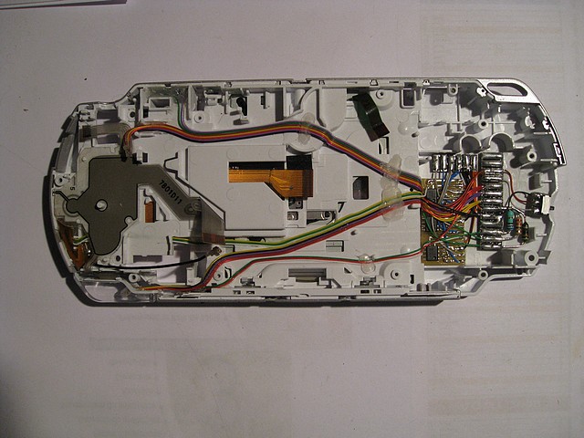

Hi all, I made this MOD with all parts in my drawers and it's not the cleanest MOD I made....
 MOD:
- Three LED in triggers > UV/Red/Yellow
- Three LED ligthing touch > UV/Red/Yellow
- 4 LED Yellow > UMD
- 2 LED Red > UMD
- 2 LED UV > UMD
- Yellow and Red LED Reactive to sound/Off/Allways On, with 2 switch 3 status
- UV LED Reactive to sound/Off/Allways On/ Reactive to MS, with 1 switch 3 status and one two status
- Custom UMD Door :)

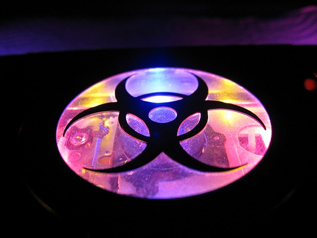

Video :
Pic :

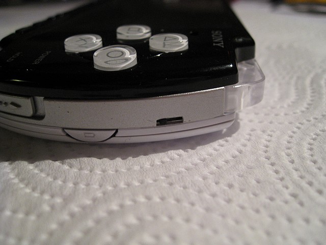

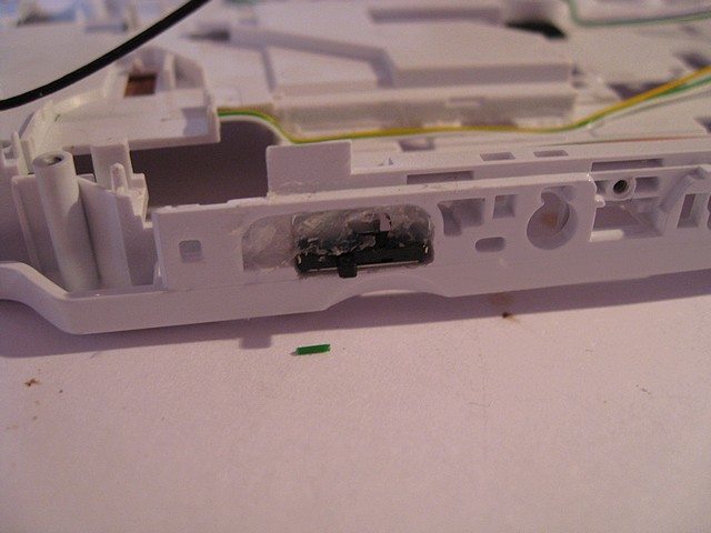

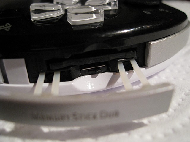

UMD door
Switch

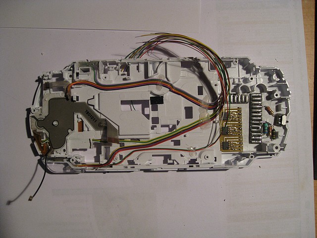

Wiring
Look
Video Soon

dude yes. i was planning on making something like this for the phat. think there's enough space for the switch at the bottom in the phat? just traded a custom psp for a 360, my only phat left over has no case, just a working mobo no lcd or speakers or anything :/ and im sorta afraid to open my slim so i cant examine the phat at the moment. Could i replace the switch with a tact switch and a pic so i could have a push button mode cycle; can you use a pic to cycle other PIC's or is there not enough current? what say you? sorry i like modding but circuits still confuse me a bit
one last thing, the strip of like... metal strips that's next to the pcb with the PIC's on it, what is that for, is it just like a passthrough for the led's so they're not connected directly to the PIC?

And :

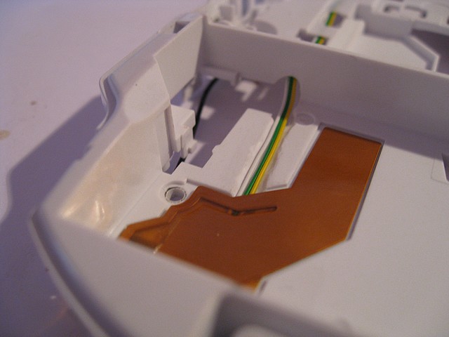

Hi so for the Phat yes you have enough space, but the slim have much space  take a look for the phat :
But if you need more space, you can find between the WIFI board, and the mother board, like this :
For the Switch yes you can take a tact swich but you need a 4013 for remplace the switch...here the diagrams:
And I don't use PIC, it's LM386 for sound reactive MOD in the PSP :
metal strips are here for ease wiring, and it's veroboard :

Hi so it's Stripboard for prototyping boards.
you can find in any electronics store, here a link to buy them on the net.
