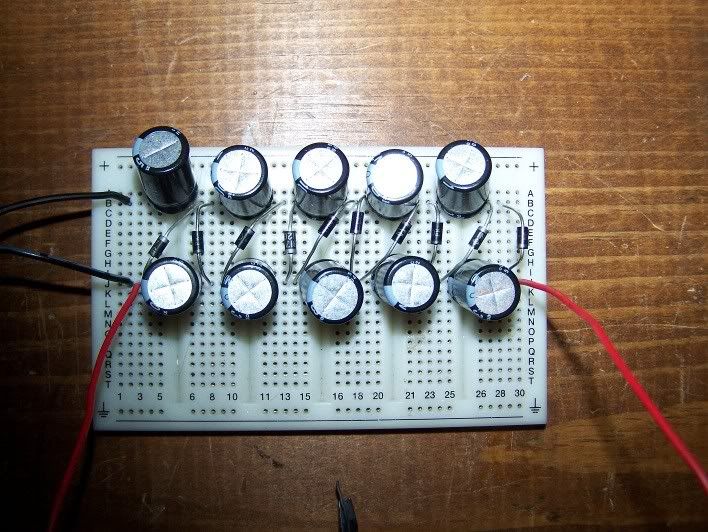

I'mma BeeF this up to something more powerful that welds with some actual 1/8" DIA welding rods.
For the record everyone don't try and weld galvanized steel, it will kill you... days later.

So You Guys Want an Encore, Huh?
Transformer Specs:
120V RMS Transformer Primary
40V RMS Transformer Secondary
Voltage Doubler Out:
40V AC RMS Input @ 10 Amps
65V DC RMS Output @ 7 Amps
Diagram:
DC Arc Welder V2 -- Much More Power

SCHEMATIC --
Hi
sorry to revice this topic.
I was looking for a week or two now, and i finally find something that i would like to build with 12v.
the problem is, can you tell me the list for parts?
i'm trying to look for those part, but i can't get the same as your pic.
i'm not an expert, but i can do well with label on schematic...
thx
and sorry again.
Offline FOOKzâ„¢
Re: Custom DC Arc Welder (BOREDEM)
« Reply #21 on: October 11, 2014, 10:50:31 PM »
Just going to say this... if you can't figure out the specs for parts you need... you probably don't understand the risks involved with building this.
Ratings on the schematic are ridiculous just so people actually don't try it.
The capacitors were rated at 400 Volts, each are 1000uF.
The diodes were some "medium power" rectifier diodes, $5 a piece I think. Something that can handle [12 Volts @ 8 Amps Continuous] or a maximum of [1000 Volts @ 10mA momentarily]
This circuit resembles a basic TIG welder FYI.
