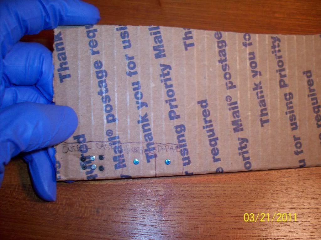

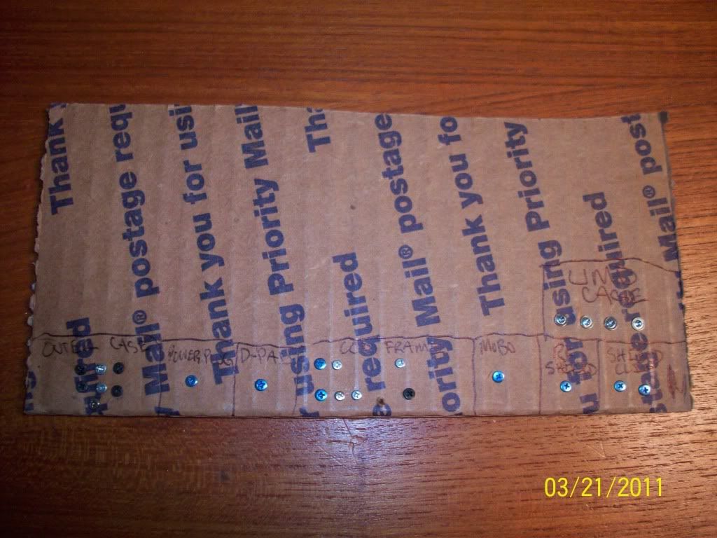

OK so I'm working on a customer's PSP and I figured I'd post a description and a few pics of how I keep their stuff orderly. I don't use this method with my own units as I'm not on a deadline with my own stuff and don't really care if I'm fishing around for the right screws or if it takes me a while to find them or whatever...
So anyway this is how I keep stuff in order when I'm doing MFH work or repairs on a deadline, this works really well for handhelds since so many of the screws look similar, it can also be effectively used on full size consoles, and it's very inexpensive and doesn't require purchasing special containers, etc...
First I take a spare cardboard box I have laying around (I have dozens of them all over the place) and I cut off one of the flaps with a box cutter. then I mark off sections and label them. then I take my #0 or #00 Philips head screwdriver (or a small tri-wing or standard screwdriver, any of them as long as the shaft is about the same size as the screw's shaft), and poke holes in the cardboard (all the way through so it comes out the back side). I only poke as many holes as needed for that portion of the device (if there are 7 screws for holding on the faceplate then I only poke 7 holes), and I poke them in a pattern that corresponds to the orientation of the screws on the device. then as I remove the screws I push them into their respective holes in the cardboard.
Here are a couple pics:
Yes, I wear gloves when working on a customers device. It keeps fingerprints and oils off of the parts, especially things like faceplates and LCDs. I use Non-Powdered Nitrile gloves, not standard powdered latex, that just leaves powder behind that looks like dust.
