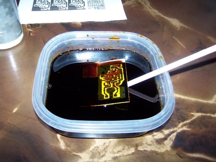

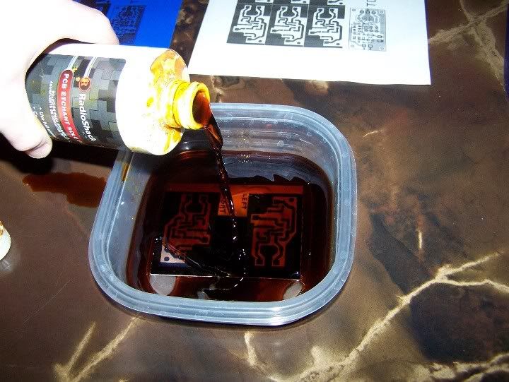

- warm the acid in water, shake well, prep work area for etching process.
Section 3 ~
- place board on optional board stand and dip entire setup into the acid bath
- turn on bubbles and keep track of time; occasionally checking consistency
- when desired etching is reached remove PCB from acid and wash with cold water
- clean with baking soda and rubbing alcohol; let dry then drill holes for your parts.
- Clean work area up, properly dispose/recycle used PCB enchant acid leave no mess behind.
