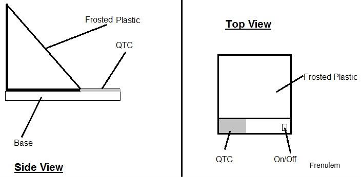

It's time for my coursework again, and i want to make a lamp........yes a lamp -_-
The details of what i wish to achieve is a RGB PIC programed multi colour lamp, so 1 green 1 red 1 blue, or 2 green, 2 red, 2 blue. then the PIC will then change the colors.
So to produce yellow the red and green LEDs will be lit, and then put through frosted plastic to give a nice affect.
For the input i want to use QTC (Quantum tunnelling composite) so the more pressure it will change colour
What i want to know is:
Is this possible?
What IC should i use?
What calculations i would need to do
Initial Design:

« Reply #6 on: December 19, 2010, 01:15:17 PM »

« Reply #7 on: December 19, 2010, 01:19:28 PM »
looks ok to me :)

« Reply #8 on: December 23, 2010, 01:23:43 PM »
Surely when you remove the pressure from the QTC, there would be no increased resistance... So it would turn off instantly? You'd need some way of stopping that, could be purely software based within the PIC though.
