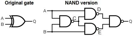

XOR or EXCLUSIVE OR
Truth table
A   B   C  D   E | Q
0   0   1   1   1 | 0
0   1   1   0   0 | 1
1   0   0   1   1 | 1
1   1   0   0   1 | 0
