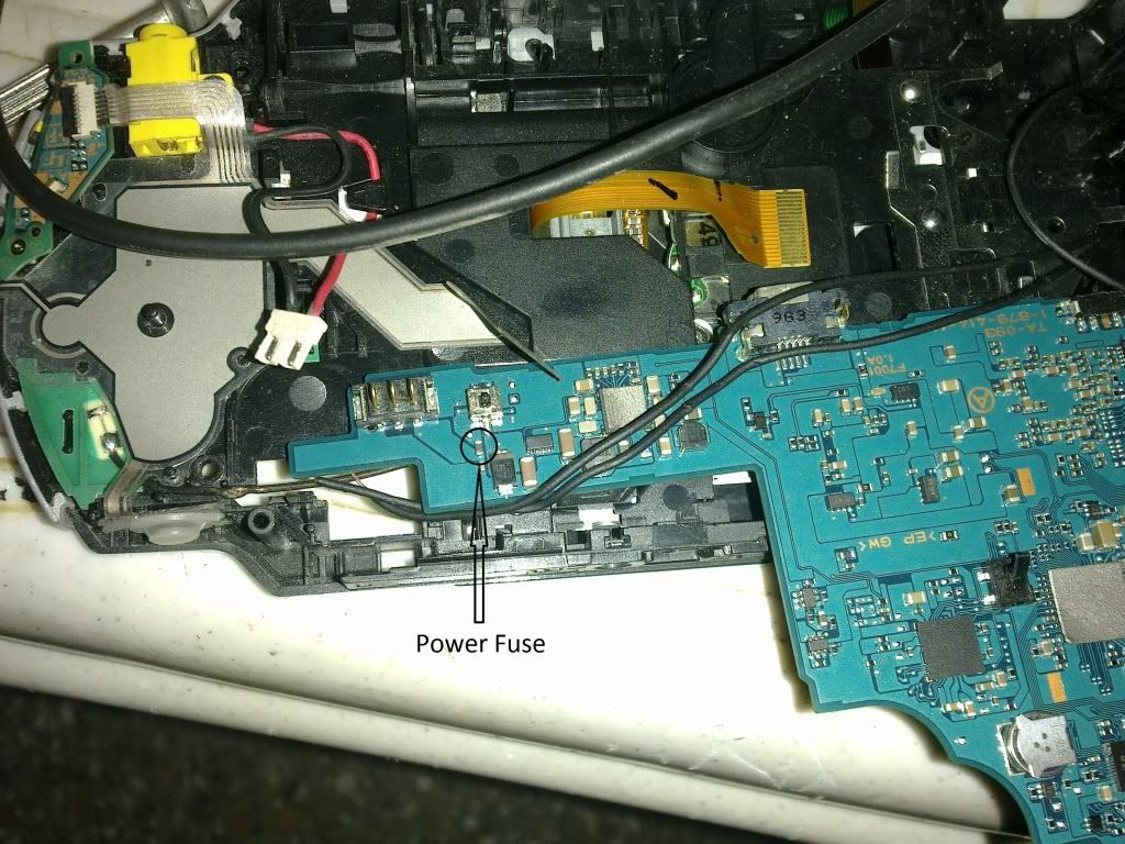

searched for the fuse, got this but dont know if this is it.
i did a continuity check on it with a DMM and its ok.
just removing the wires that i soldered removing the mod,
hopw this works out.

sorry forgot to post a image
here is a image of the fuse
i Have a PSP slim lite grand turismo edition, the Mobo is TA-093
Modds - all i have done till now is soldered wires to the speakers point on the mobo and soldered a 3.5mm jack on the other end

is that the power fuse that i have marked in the image. if yes then i will go ahead and bridge it
also can you tell me how to find the sound fuse

right this guy has the same probs as you on a psp 3000 and i read this
(Check them all with a DMM (digital multi meter, these are not expensive tools at $5-10USD), the fuses should have continuity and/or no resistance across the fuses. The 3 point thing labeled in your picture isn't a fuse.
The first thing to try when a PSP shows absolutely no sign of life when it was previously working is to leave the battery and AC out of it overnight - it gives the main system controller of the PSP a chance to run it's internal power supply dry (a dry cell soldered onto the mainboard) and thus 'reboots' itself to allow power on again.
GL. )
and he said the fuse in question is
Got it
it's actually the fuse marked "TB" got tonight but failed to solder.....................but it works

found the fuse labeled TB and did a continuity test and its ok just working fine

« Reply #26 on: February 02, 2011, 12:47:18 AM »
thought it would be the power fuse tbh shows what i no
Offline sdinesh86
  • Posts: 13
Re: Need Help with PSP 3000 Headphone jack
« Reply #27 on: February 02, 2011, 01:29:52 AM »
at start i also thought i might be the power fuse.
but then after post i remembered that last time when changed the screen that guy had changed the power switch and the ribboncable tooo.
so thought that would be the problem checked it and that it was !!!!!
Post Merge: February 02, 2011, 03:56:34 AM
Found the root cause of my problem.
the ribbon cable that goes to the power circuit board had a problem, the problem was that the hard plastic film that is with the cable for support had moved forward, so coz that the pins never came in contact with the pins on the connector, just trimmed off the access plastic and inserted the ribbon cable and it worked just awesome.
« Last Edit: February 02, 2011, 03:56:34 AM by sdinesh86 »

« Reply #28 on: February 02, 2011, 09:40:20 AM »
Ah!! So glad that you found your problem!! You always have to remember when troubleshooting, sometimes the problem can be things that you have never heard of before.  I'm really glad that my knowledge could help, and I'm glad my zif method worked :D
