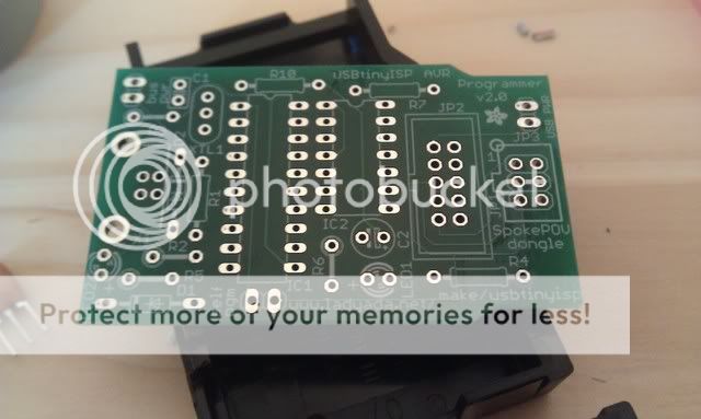

heres the little board i made to program the avrs, im using a bobby pin to hold the chip in place
theres a 6 pin header on the other side of the board

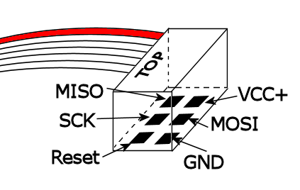

i have it wired according to this, i assume the pins are correct?

« Reply #18 on: May 25, 2011, 12:48:26 AM »
i believe all the connections on your programming header are backwards....
if you solder the header so the pins are on the copper side i think it should work

yeah ive been pretty slack with updates i havnt really had any time to work on it, i had a good look around online and found i had the programming header wired backwards. lol.
it all works fine now, i just need to etch another pcb so i can program the SOIC avr
