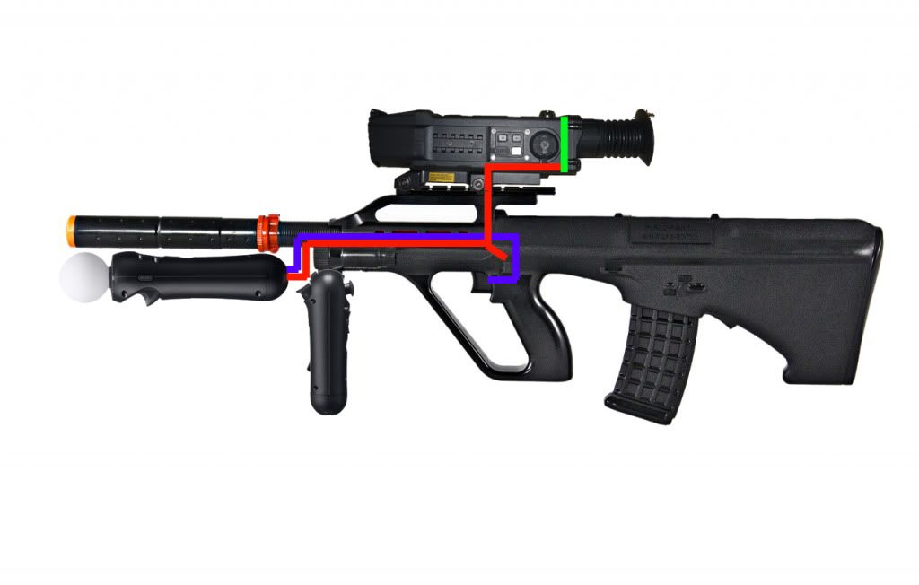

2 quick ideas on how to do this.
1 with a camera set on like a coffee table pointed at the screen the redisplayed onto a small screen in the scope.
2 split the video output of the ps3 and then send that signal to the screen inside the scope.
hdmi can be split (see http://www.iec-usa.com/cgi-bin/iec/ADP5402 for hdmi split and amplify) and so can standard composite (composite splitter here http://www.21best.com/21_best/electronic/security/video/amplifiers/for_sale_.html#VD12 ) . I don't know about component video though.
I think I will try option #2 .
problems....
             how to switch to scoped view?
A simple answer just a momentary switch. say trigger hand thumb button. Once the "ext" port on the move controllers is figured out just tie into the signal for "look down scope" button. L1 on standard controller. not sure which controller controls this for the move controllers but I am guessing its the actual move controller handling look down sights button. A real answer to this would be nice.
Answer : In killzone 3 the nav controller controls look down sight function but remapping is possible I've noticed in all Shooters, Gotta check on new socom yet. The nav is preset to left side controls of the dual shock. with added x and o buttons.
A solution to this came to me in thinking about a solution to the digital trigger (fire button) problem. instead of a 2 wire plug between the move controller and the gun , use a stereo headphone jack. 3 wire. now use second wire for trace on aim button and connect to switch on display. Auto video scope.
       Power? I have a 5" lcd that runs on 12vdc. A lil large but good for proof of concept.
       Finding a small high deff lcd?
this one maybe
http://www.lcdshow.com/1Small_video_LCD/3.5in_Video_LCD/3,5_lcd_for_video_monitor.htm
        transmitting video with no lag?
Maybe this setup for wireless video. Receiver runs on 9vdc , so that's a plus.
http://www.iec-usa.com/cgi-bin/iec/fullpic?ud6RL8Hj;ADP5111;6
or
http://www.securitycamera2000.com/products/Wireless-Video-Audio-8CH-2.4G-500mw-Transmitter-and-Receiver-Kit.html
           For the overall design I was thinking about something similar to real infrared scopes. the screen is hidden inside and you actually look through real optics to get a proper view of the screen inside.
Any input or help is greatly appreciated .
I still need to figure out how to switch to scope display automatically when I aim.
this is my AUG design.
