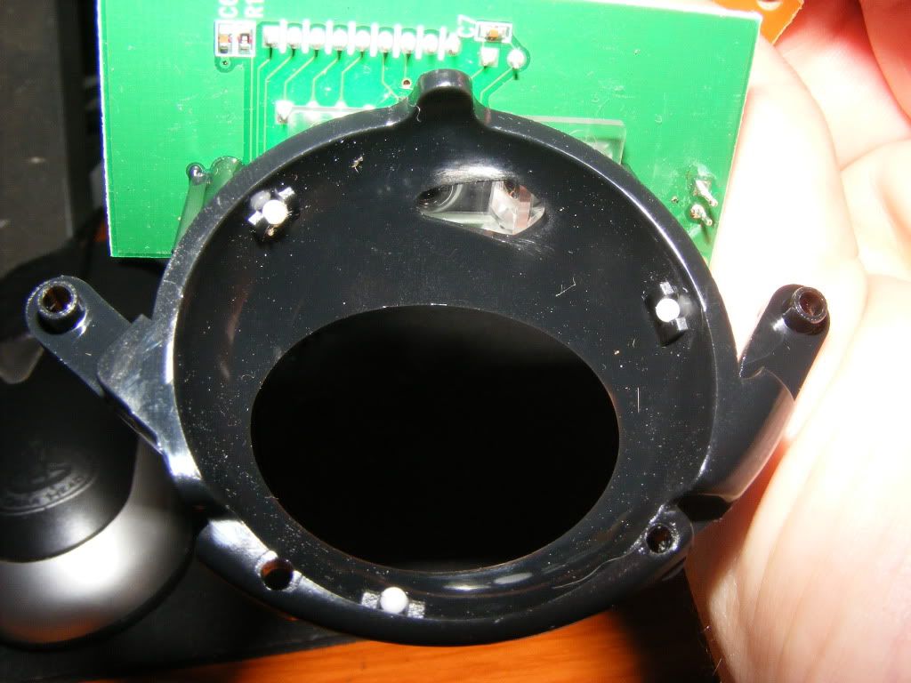

So out came the screw drivers to break down my optical track ball mouse.
Now by design the size of the ball should not matter to the optics because its a sphere. as long as the optics are lined up on the equator it should not be an issue. If you look in the pic that shows the socket it has 3 lil nubs that stabilize the ball.
pins starting from black. 1=ground,2=5v constant , pins 3-6 start at 5v and vary depending on movement. I cant tell if these are directional pins because of the nature of the track ball i dont know if i am moving exactly up or down or left or right. pin 7 say 4.88 v lil less than the constant 5v . The last 2 pins are low v and vary w movement also.
If you look in the pic i took a snap of the video demo. In this pic you can see the lil nubs ,mounted in the analog socket. That is what holds the ball in place. They are like bearings .

I found the pdf file for the A2051 chip in your trackball from the first set of pictures:
http://www.bidouille.org/files/hack/mousecam/ADNS2051.pdf
That chip (and most likely any USB powered trackball) runs off of 5V power, something we dont have in a X360 controller. Now, wireless optical mice are a dime a dozen. I am going to find and hack one up on my end to get chip info. Hopefully we can source a good cheap optics that runs off 3V (double AA power).
The second thing on our shopping list is a ball and the plastic housing that would fit just right in the empty socket of that analog stick hole (just like the controller we are trying to duplicate). It would be nice to come up with a way to do this without major bondo work to the controller.
The last thing will be to see what kind of interface we can get from the optics and turn that into analog voltage. That part (to me) is not the hardest part of this project, its finding the right parts to make a good solution.
