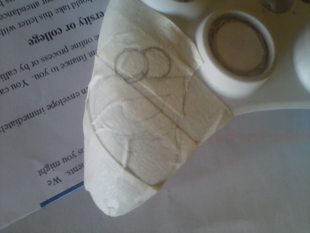

Whilst i was waiting for this competition to start i drew some rough pictures of how i wanted everything to look on the controller itself. Bought blue Acrylic paint... £2 out of my original £3 budget, FML. Today i merely sanded the controller down with wire wool and cleaned it with soapy water, ready for priming

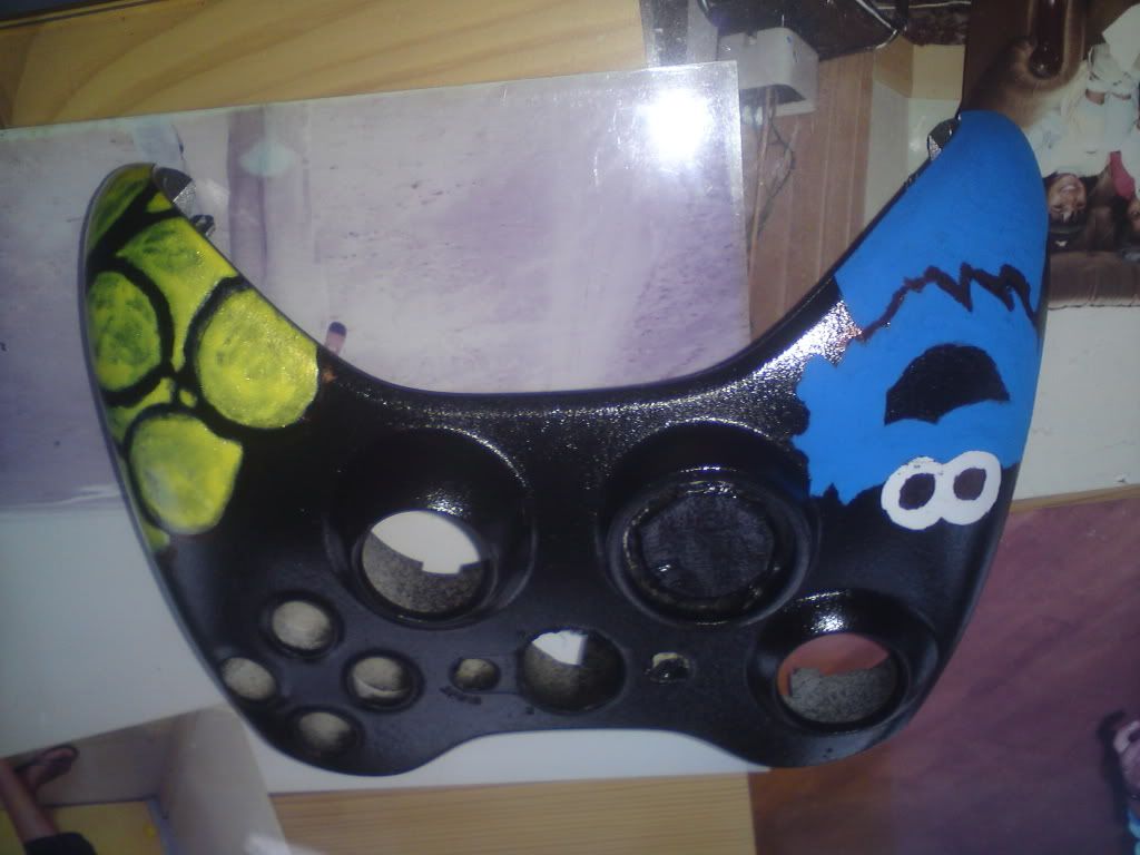

Patience my young padawans spray painting takes its sweet time. Today i sanded the first layer (four subcoats) down with 1500 grit wet sandpaper and finished the second layer ( another four layers of impressive can control). I also whipped out my paint brush and painted some pretty beastly pictures, enjoy
16th Aug
Sup chumps, twas a slow day today. just finalised the painting ready for the clear coat and made my ROL blue, casually only found to so i resorted to using 2 pink and 2 blue... but I'm gonna act as if its supposed to be like that ok so don't tell ANYONE or i will hunt you down and ask you nicely for blue leds.

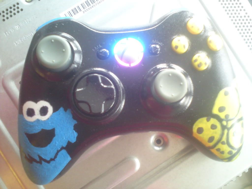

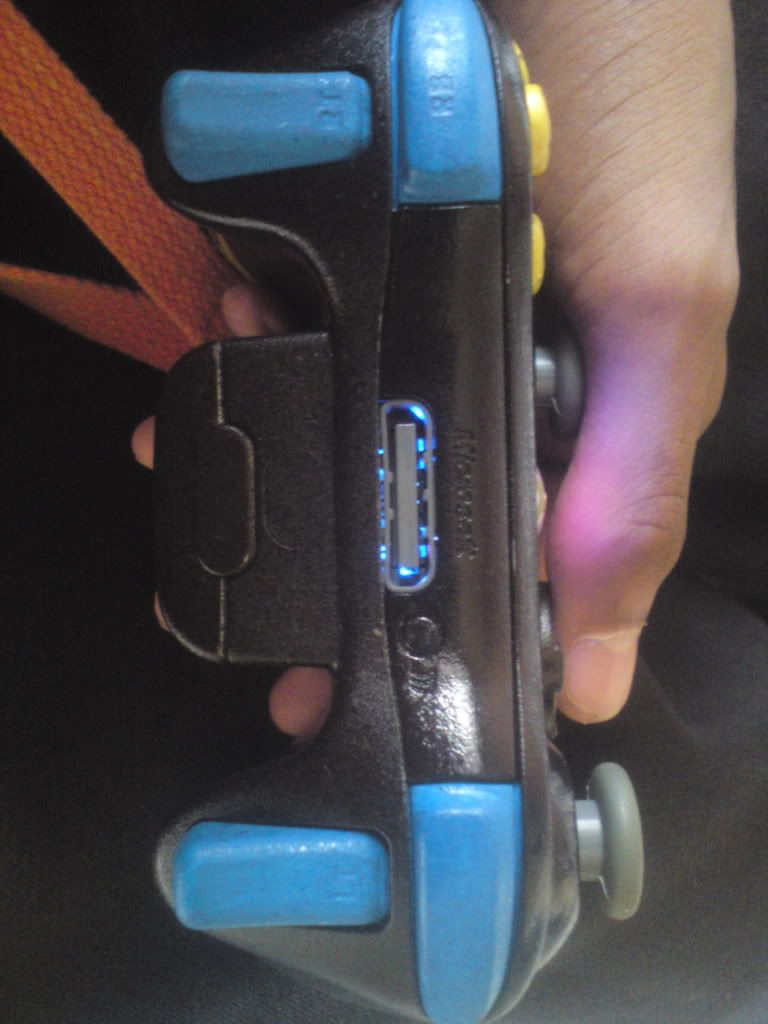

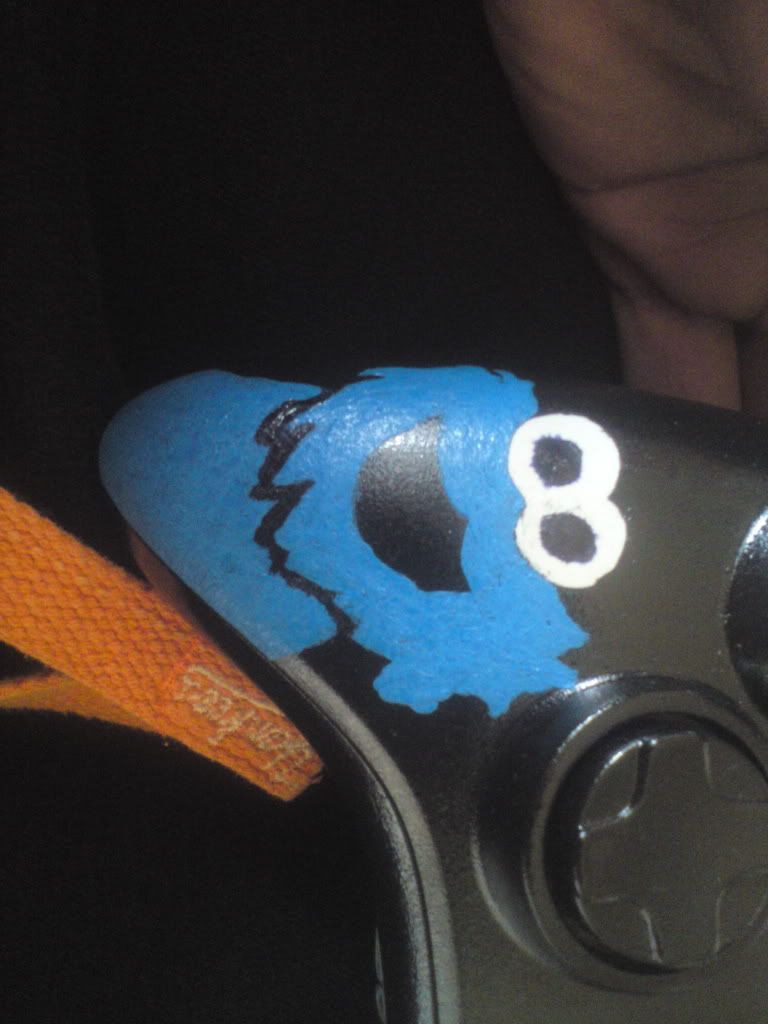

sorry all my eeager followers about the lack of daily updates but one was sorting uni stuffs out. COVENTRY here i come. anywho controller is done and dusted. enjoy

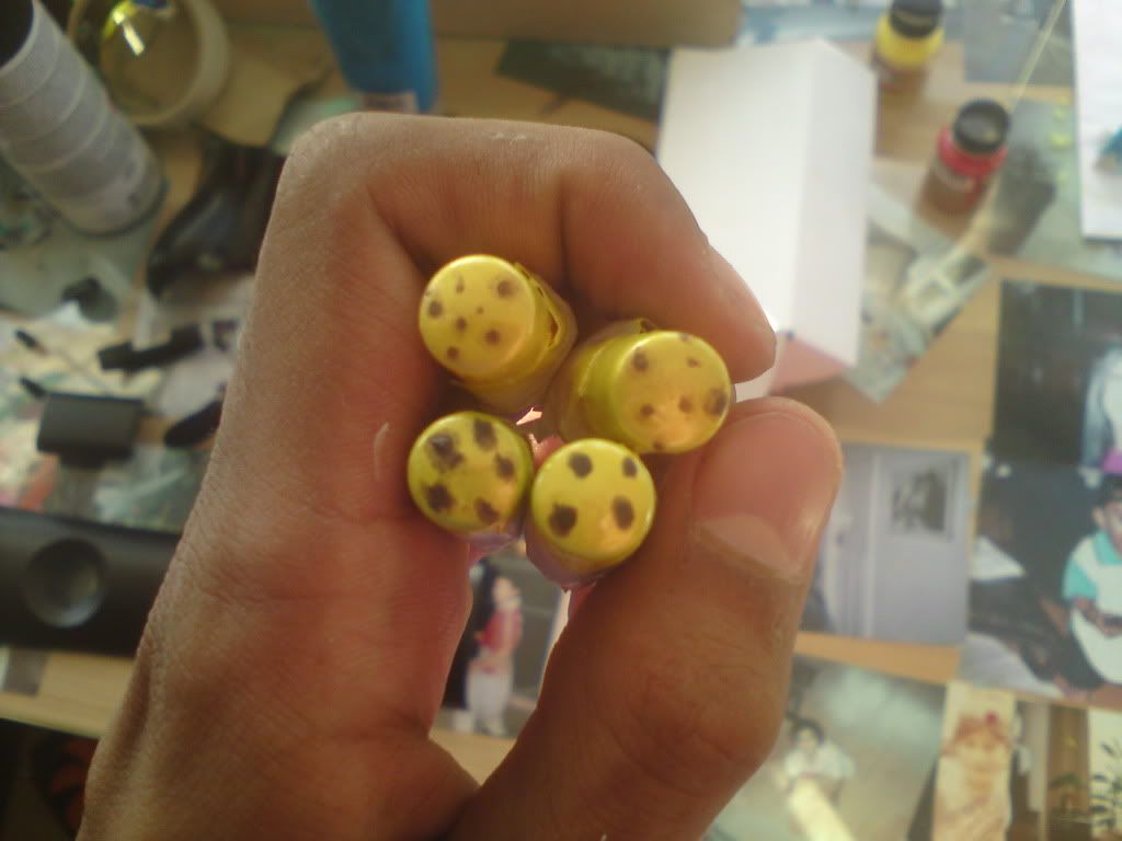

so what do you think. release your inner munster
Looking pretty good there, nice work cant wait to see the finished product.
