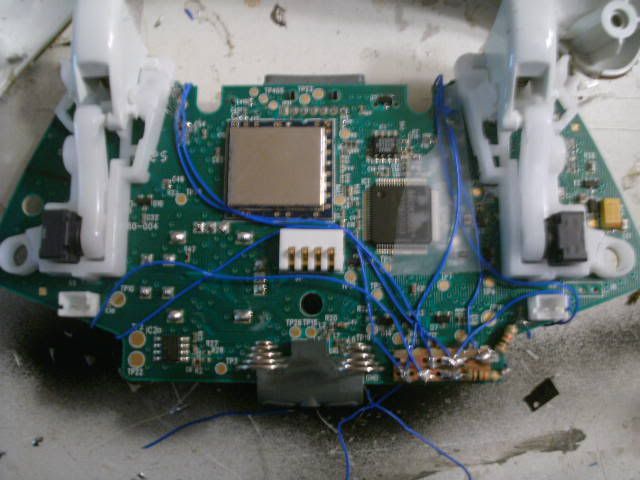

I finished what I can do for now as I burnt out one of my 4 blue leds. But anyway, the mod looks great although its missing 1 led. I worked on this mod for about 5 hours this morning!
video shown below V
here are some pics of the insides
« Last Edit: September 29, 2011, 02:08:04 PM by drummerdude »
Re: Drummerdude's Stand out controller
« Reply #19 on: September 29, 2011, 02:02:33 PM »
Nice work I couldnt edit your post but hopefully this will help out for people to see :)

Yeah! I originally tried to have 3 leds, and i successfully did it on the first quadrant, but then i actcidently ripped the pad. I bet i could add a 3rd led now, but i dont wanna risk braking my last working controller.

follow the ripped pad back to the track scrape the pad with a exato knife or scribing tool till you can see the copper flux it with either liquid flux or paste flux and then you can make yourown track or just use some wire and it saves you shelling out for a new controller if the pads are coming off like that use less force when soldering. to stop this happening again turn the temperature of your soldering iron up to about 415 degrees celcuis flux the components/tin the wires before soldering them on and dont hold your iron on the pad for too long that causes it aswell i hope to see this working it looks fantastic
