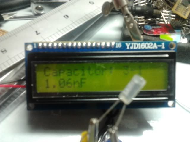

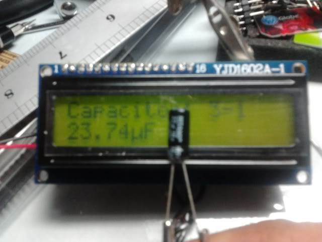

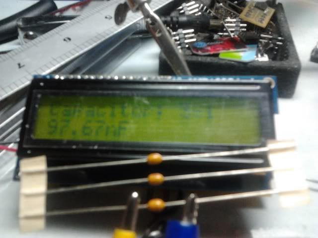

I finaly got mine finished off and working
I designed  a small  double sided PCB for it in Kicad and got 10 made up
by Seeed studio for less than $10, Its not worth etching your own at that price .
When I first tested the unit it worked fine for diodes, transistors leds and mosfets etc
but was reading high on capacitors , when I say high it was a serious ammount high
, like 60% too much . A 10uF cap would read 16uF. Then on  www.mikrocontroller.net
I saw a post that gave the answer . It was not easy because the forum is in German
and I only speak English , but it seems you need to change two numbers in the source
file and re compile it
it was here
//  unsigned int H_CAPACITY_FACTOR EEMEM = 394;     //  Standardwerte für M8
//  unsigned int L_CAPACITY_FACTOR EEMEM = 283;     //  Standardwerte für M8
    unsigned int H_CAPACITY_FACTOR EEMEM = 262;     //  Standardwerte für M8A
    unsigned int L_CAPACITY_FACTOR EEMEM = 177;     //  Standardwerte für M8A
I had originally used the two top numbers  394 and 283
I changed them to  262 and  177 and now it works fine
Capacitors now read within there rated tolerance from 100nF to 2200uF
