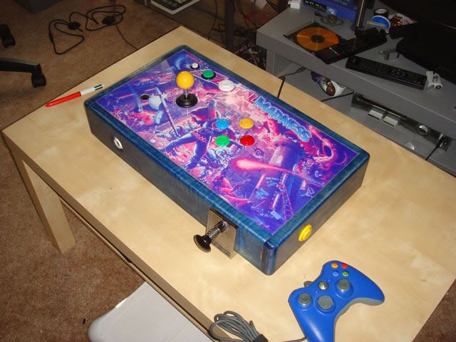

I'm making a pinball controller for my Xbox 360 since I'm addicted to Pinball FX 2 and Pinball Arcade at the moment, so I want to emulate that Pinball feel with buttons that are to the sides of a box with a plunger at the front.
I managed to find this. This is exactaly what I'm making, an arcade stick like controller that has buttons on the side and a plunger...

OK cool, thing is, I'll be needing a sliding pot where it's up-most position sets to neutral, so from what you said Matt, that's 0.6v, and the bottom most position sets the voltage to 0v. From what I read on the site the that the picture came from, a 10K slider was used. But looking at the pictures of the Plunger assembly the slider's position is actually near the centre rather than the up most position, which may suggest how the Y axis up most position is 1.5 volts, and the down most position is 0.0 volts. I'll have a look around the net and stuff, but thanks for telling me about the voltages that the analog sticks work on! :tup:
Ok, I had a look at the video that was on that page, and yeah it made some sense about how he set up the slider pot. It needs to be set to as close to 5K as possible, and as the 360 syncs up the pad it will use the pad's analog position as it's centre. So in my case it'll be near to 5K Ohms. The rest should be a simple wiring/shorting job. The only real issue that I'll be having is a woodwork as I don't have real woodwork tools on me. Hopefully I can borrow some off friends and relatives.
