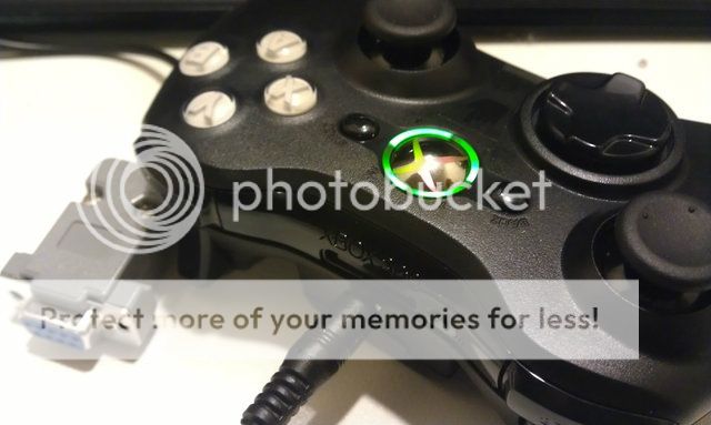

Well guys finally I have my controller working  :tup:
I would like to give special thanks to Hazer for the code, phantomz0 because he has helped me a lot with PM, pics, etc (I think I have been a pain for him) and also hyper and the others members
Here are some pics of my controller:

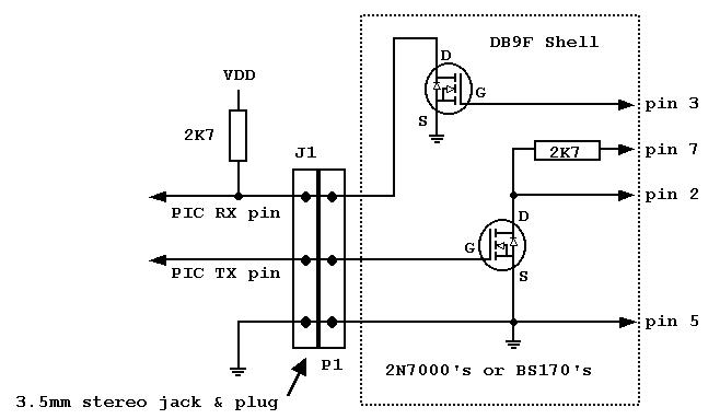

I drew this up in paint when I was installing mine
This is for CG controllers, the only thing that will change with matrix controllers is where you get power from, the rest of it is the same.

there are no capacitors, I just checked my diagram above, its missing the resistors on pin 4 to rx, it seems to work without them but its probably best you put them in.

sorry i meant resistor. i have an original board from when hazer was selling em. when i get a chance ill open the troller and take a flick.
