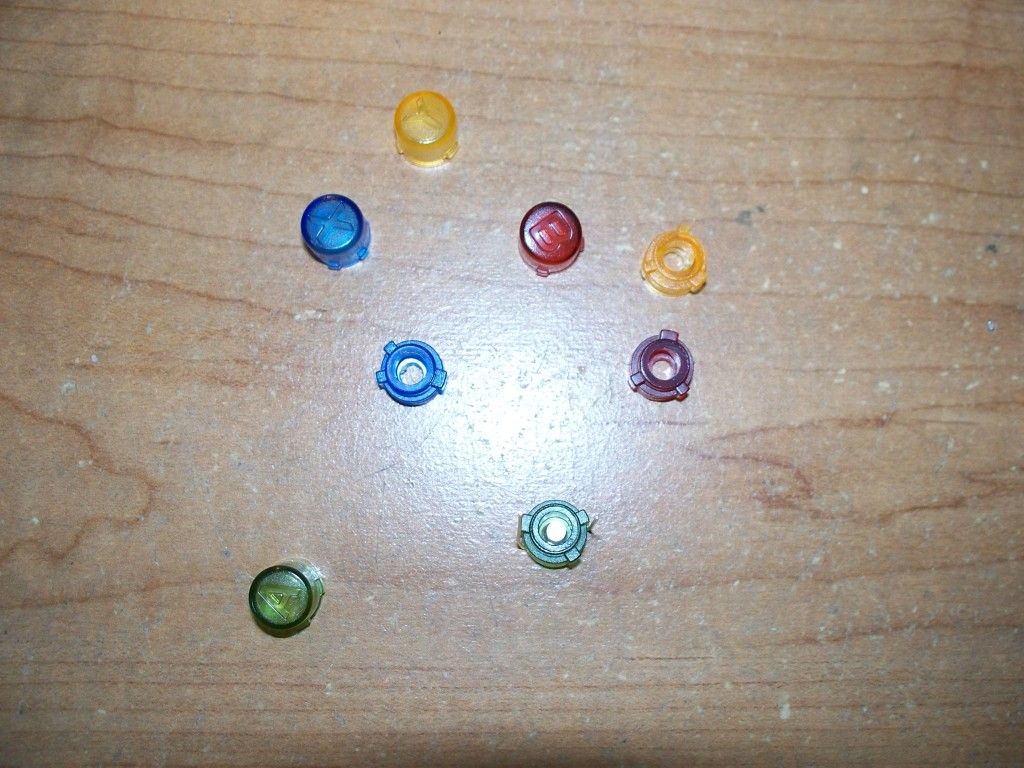

I got this controller super cheap with a console i had bought. Figured i would do some type of mod for it. these controllers are pretty cheap to pick up secondhand.  Push button lighting will be done on the abxy and then will work from there ... just thought i would share with you guys.. cheap controller , little bit of time and I am hoping to turn this cheap controller in to something worth wild to sell...  the abxy buttons come apart in two pieces makes 3mm leds fit right in the lower part of the buttong i tried to take a pic , camera just wont focus on small stuff

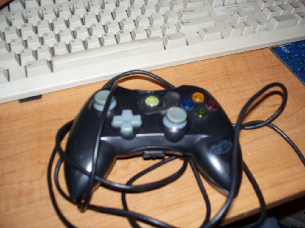

stock wired Madcatz controller

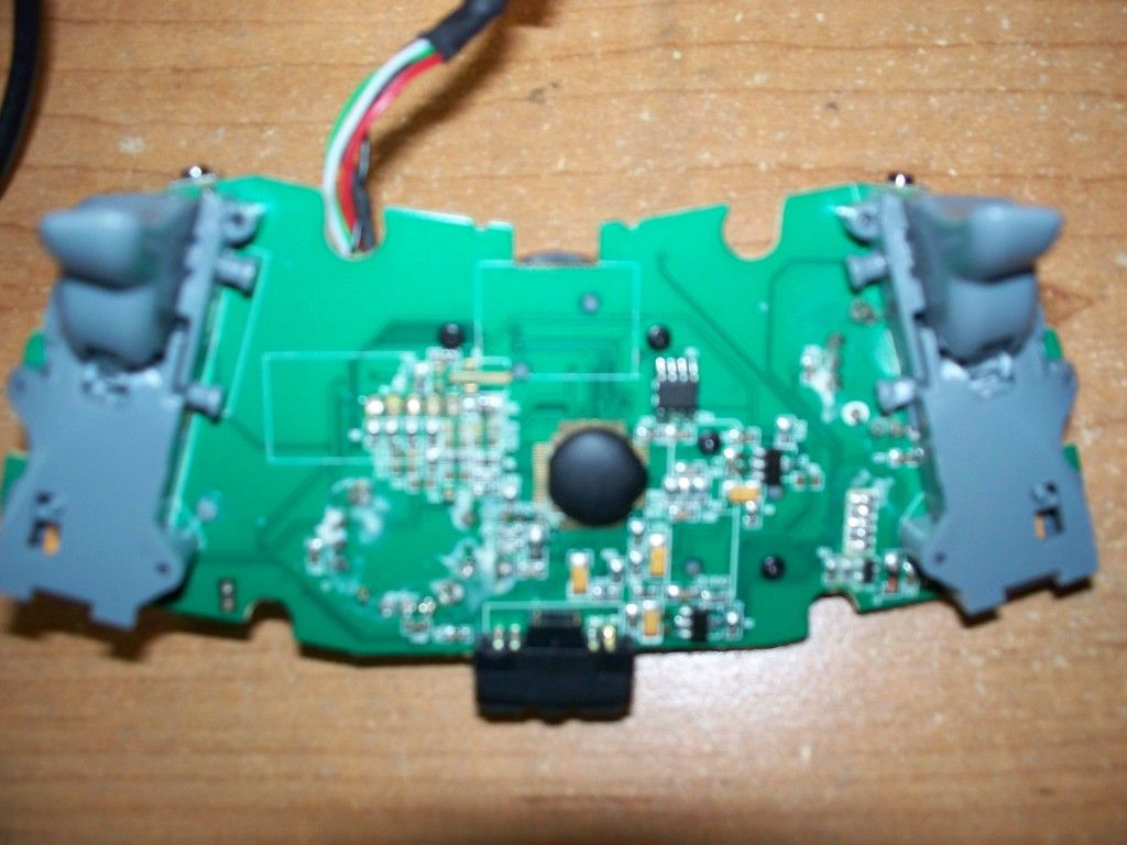

Controller board after i disassemled front
Back

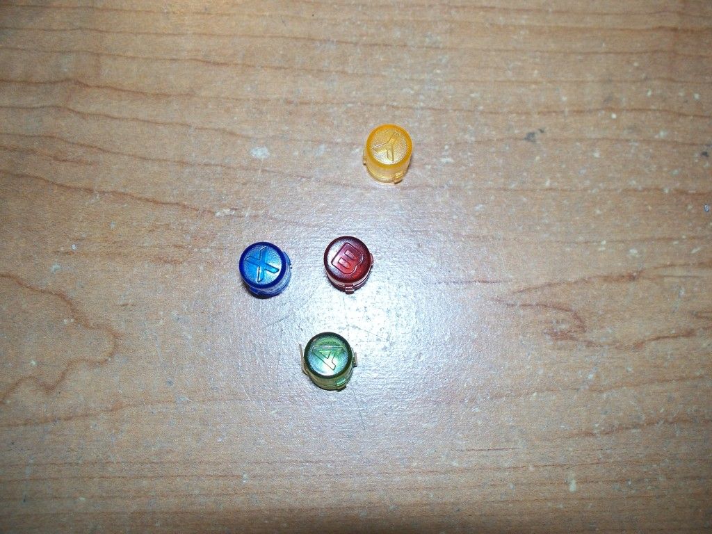

Buttons
Buttons are 2 peices

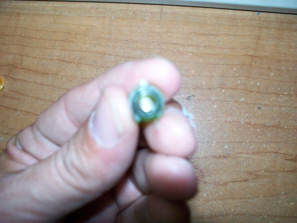

3mm led fits almost perfectly in the 2 pieces I drilled a small hole in the bottom to hot glue in and let the electrode sitck thur the button

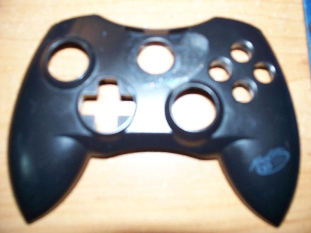

shell front
Shell back

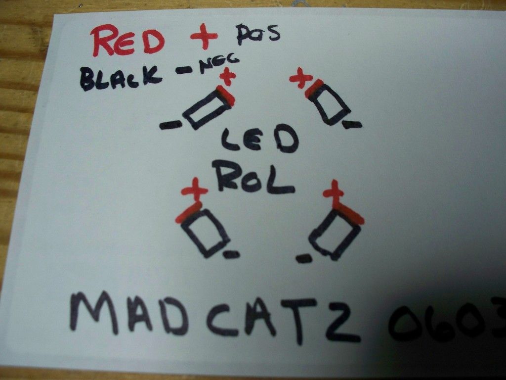

ROL points
