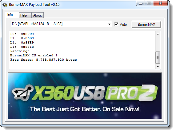

C4E is the man – this really is an amazingly cool app – serious top shelf hacking !
C4E’s BurnerMAX Payload Tool in association with Team Jungle & Team Xecuter
Official release of the BurnerMAX Payload Tool – works with most MTK chipset based DVD burners (Liteon etc)
 - No need to flash burner firmware
 - Delivers a realtime payload to increase capacity of DVD+R DL discs to support XGD3
 - Support for stock iHas B, C, and D burners, all makes and models
 - Support for many of the Liteon iHAS Clones
 - Supports many other models such as ASUS, Samsung, Pioneer and many others
 - Supports many Liteon and Samsung USB External Burners
 - Supports many Liteon IDE Burners
 - Supports any disc burning software – we recommend iMGBURN
How it Works

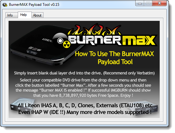

Load your favorite burning software. Insert your blank DVD+R DL disc. Send the BurnerMAX Payload. Re-select your drive in the burner software and the capacity will be increased.
 You will need to send the BurnerMAX Payload evertime you insert a blank DVD+R DL disc.
Special vendor specific commands are sent to examine in realtime the drives custom registers, searching for specific DVD+R DL blank media capacity and layer capacity parameters.
If found these registers are modified using another set of vendor specific commands.
Due to the use of stock firmware and different burner makes and models, any settings the burner has play a more important role.
For iHas burners B, C and D, recommended settings are:
Force Hypertuning – Enabled
 Online Hypertung – Disabled
 Smartburn – Enabled
 Overspeed – Enabled
 OPC history – Do not clear
Results may vary depending on hardware and disc brand.
Verbatim DVD+R DL (Singapore Manufactured) Blank Discs are recommended for best results.

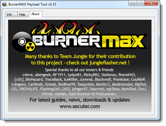

Thanks go to Team Jungle for their hard work and efforts in the development process.
 Thanks also go to Team Xecuter for their support to this project.
