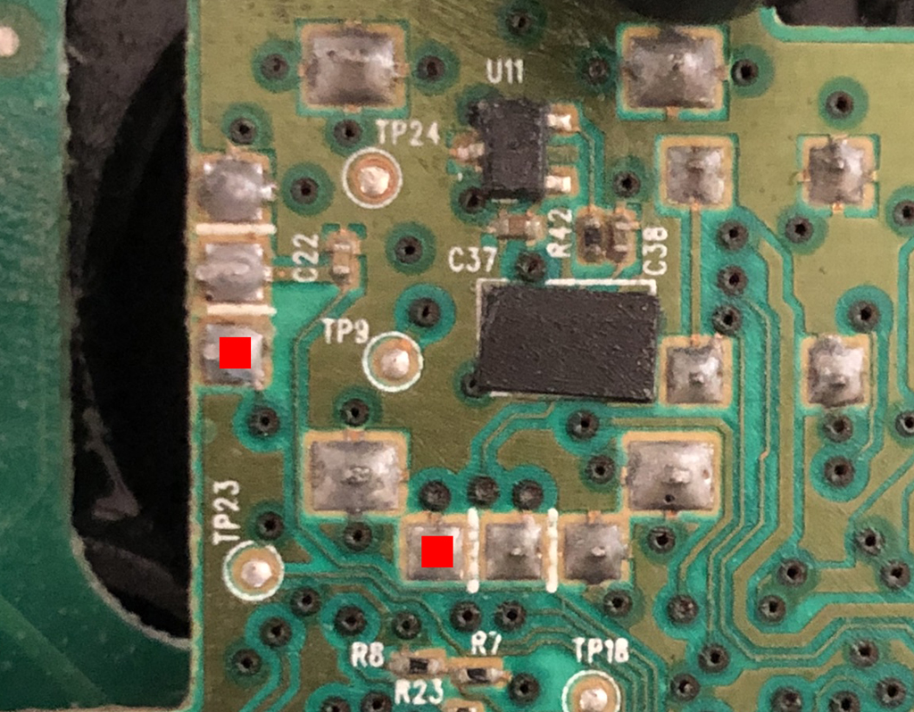

yes I've read your comment about the importance position of R34 and R35  :yess:
Quote from: RDC
Each of those Caps have 2 connections, one side being ground, and no idea how you 'shorted' those together, so you may have something shorted to ground. Already said that I wouldn't do the U3/U2 thing, unless you pull Q10 first so the Rumble circuit gets no power.
please check the image of the point where i shorted it, and i've check it with DMM,  the voltage line is okay and no shorted to the ground, but i dont check the exact value of the voltage
and i already disconnect all 4 vibrator, but i dont remove the Q10
i think i've just wait the mp3414 replacement to arrive
thanks anyway RDC!  :cool:

Yeah those are the right spots. It's either too much of a load or there's another issue somewhere.

confirmed: i've switched the position of R34 and R35 :rofl:, but when i try to swithed it back, obviously one of the super duper extra tiny resistor is missing, the 190k one.
what type is this resistor?, and if i'm try to used one of the resistor from unused U1 circuit, R17 100k, what will happen?, i'm assumed the output voltage from U3 must be higher than 3.3v, since the voltage divider value is getting higher if I'm using 100k as R35 (90K lower than the original value 190k)
thanks RDC

@ blinkerss - The voltage output value will be off. Look thru the Datasheet for the chip if you want to know what it will be exactly, but it's not going to work that way either. You need a 190k 1% or better value Resistor there.
