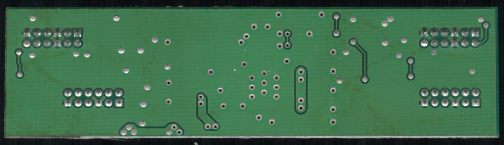

This is the Daughter board. It's only in the v1.0 XBOX.
TOP
BOTTOM
Some common issues with this thing are the 5v and Data Inductors.
The 5v Inductors, L4, L5, L7 and L8 can become brittle and if the board is removed one too many times they can crack and then no 5v gets to the controller. It can be replaced with a short piece of wire if one is found to be broken.
The Data Inductors, L2, L6, L9 and L10 can be knocked off the board if one isn't careful, especially L2 and L6 for ports 3 and 4, as unplugging the Power/Eject cable can tear them right off if you're not watching.
Aside from those issues though, about the only other thing that can fail will be the hub controller IC, U2. This is a TI TUSB2046 4-port hub in the LQFP package.

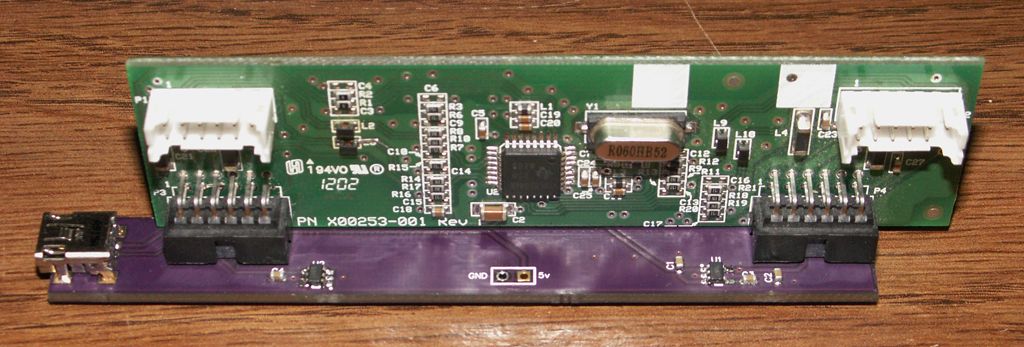

Just to kill a little bit of free time, I decided to make up a test jig PCB for these things, versus having to mess with wiring up a USB cable to the connectors, Tact switch and such. Now it's just plug the Daughterboard up and use a miniUSB cable to check it on the PC.
The GND and 5v spots in the center are for supplying the Daughterboard ports with the 5v they need. U1 on the right is a 3.3v Regulator for powering the Daughterboard and U2, which is a 10F220 to do the Rest line timing, bit overkill but it's done now and I doubt the thing will ever get used again anyway.
